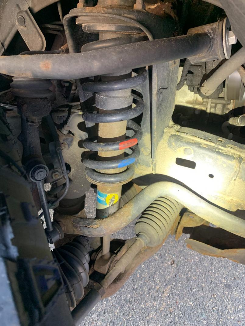

Hello all, i've searched all over for pics of stock suspension but can't find what i'm looking for. Would one of you fine gents be able to identify these springs? I just bought this 04 v6 with 165k, its got 5100's but i can't identify the springs :ybrick:
[MENTION=635746]NHToyo73[/MENTION], Toyota marks their springs like that to indicate the side on which they should be installed. Not sure if other manufacturers make similar marks so that may or may not be of help.
