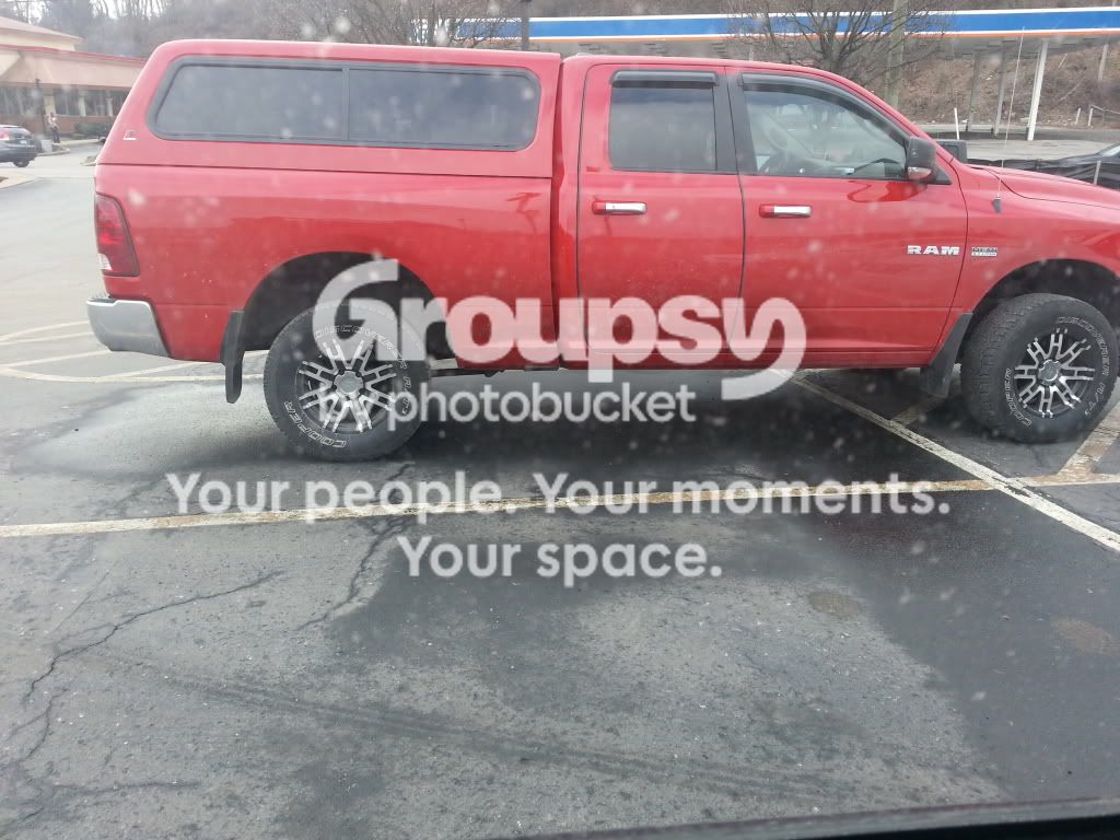

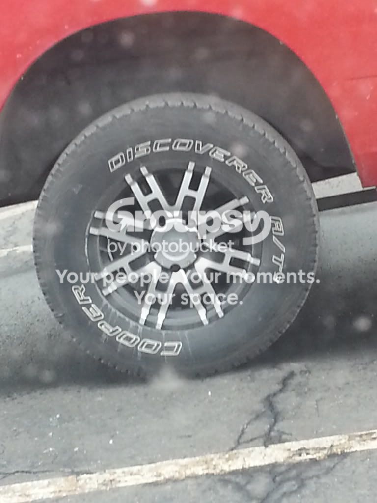

Anyone know what wheels these are? Saw them in the parking lot..
20130223_143824.jpg~original
20130223_152440.jpg~original
wheels
I think their made by pro-comp shows a wheel like n their mag. Might be on their website too Stan .Just ball bustin on my 1st Sat . night beer.
wheels
They come n 3 styles machined , chrome , & black ,169$ for 1st & 3rd chrome is 236$ 17x9 what you been looking for right ?

Ok then let me look n my 4wheel parts mag. & see if their in em !
All good. Looks like the 8101's. Thanks much. On my third beer if the evening myself. Haha
