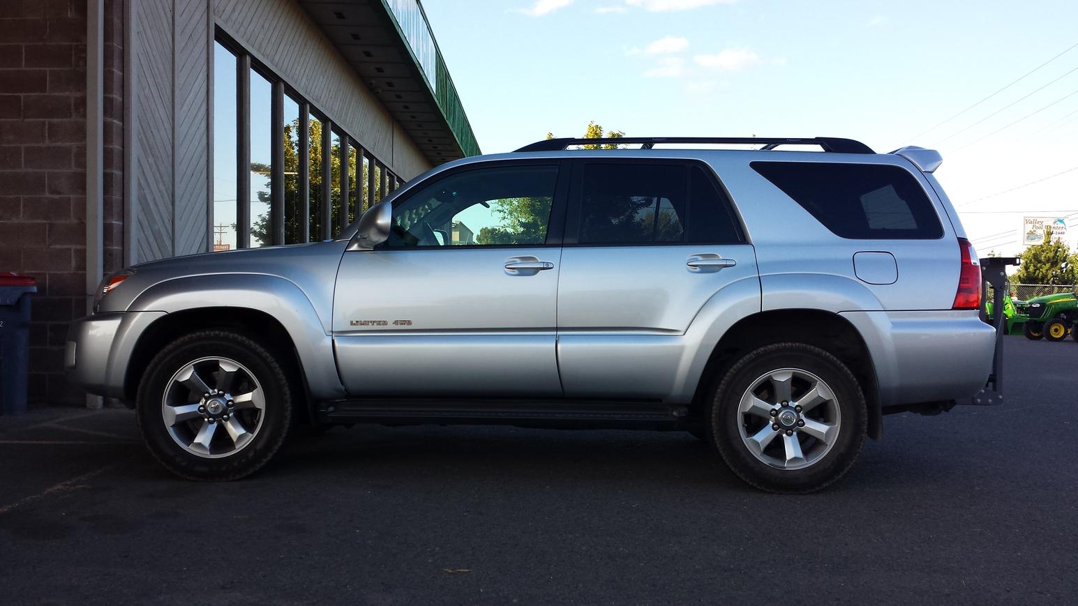

Bilstein 5100 Front Setting Recommondations
Based on the picture should I got .85" or 1.75" to level out my 07 Limited? Stock Springs original shocks, Have front and back Bilstein 5100's installing in a couple days.
Thanks
From the looks of Pic, go with .85. However to be sure go measure fenders. measure from ground to fender edge in the middle of fender. I use wheel cap for reference. You want roughly a 3/4-1" difference to look good front to rear.
