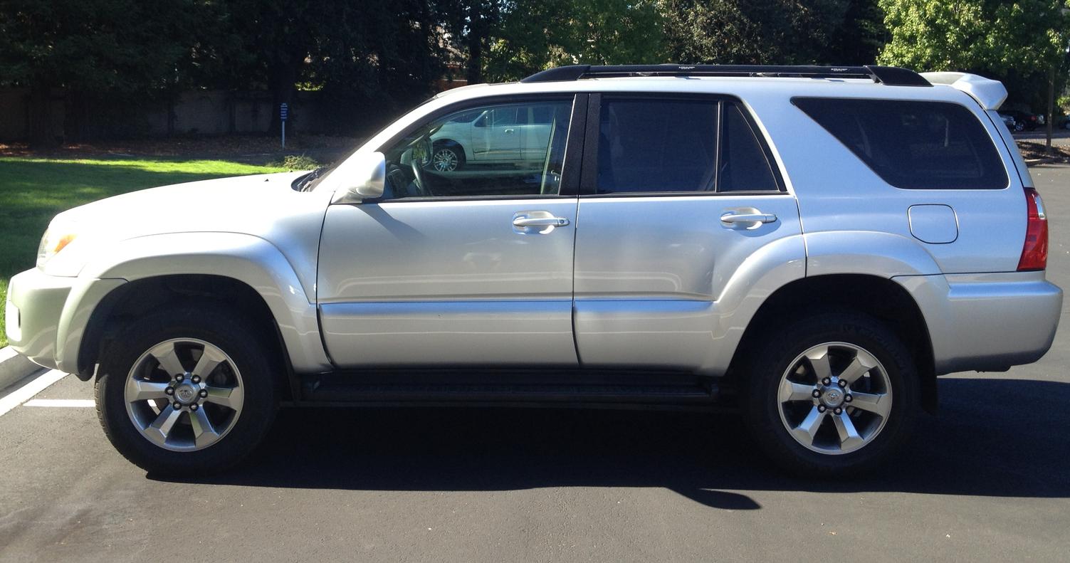

Since we have the same exact ride I'll post my experience. Mine has ~105K miles on it and I think my front springs were pretty cooked. I initially put FJ coils/shocks with a 1/2" Toytec spacer and didn't get anywhere near level. The FJ springs just didn't net that much lift, if any.
Round 2 was the Daystar 1" spacer and I put airbags in the rear. This is a lot better but I still think I should've done 5100's at the 2nd setting with no spacer. I may end up adding 5100's in the front at .85 eventually but I want to see how it looks with 255/70/18's Destination A/T's on it first. Taking apart the front is a lot easier now but still a pain to do more than once.
My measurements are all +/- 1/8". The driver side sag remains to my dismay.
It had a little more than 1/4 tank with no PSI in the bags
Front Ground to Fender flair
Driver/Passenger
34.75" /35.25"
Front Center cap to Fender Flair
Driver/Passenger
20.5" /21.25"
Side step to ground
Driver Front/Driver Rear
12.75" /12.75"
Passenger Front/Passenger rear
12.75" /12.875"

It looks nice now for sure I like the way it looks. Putting on mine tomorrow going to go with the .85 will see how it goes. Its amazing how much info there is on these threads regarding this and how the same setting can look different from rig to rig.
I don't know what your measurements are front to rear and it's probably to late for you to grab some FJ springs but my observations are.
1. .85 setting on 5100's with stock springs will probably not get you close to level. I think you'll still be 2"+ rake.
2. The ride with FJ coils/shocks is a huge improvement (Non XREAS). If you can find a set it's worth it.
Your pic is a little deceiving too as it appears you're parked slightly uphill.
As it measures now 33 1/4 bottom of flare to the ground on the front and 35 1/2 bottom of flare to the ground on the rear. Would love to do the FJ upgrade in the future.
