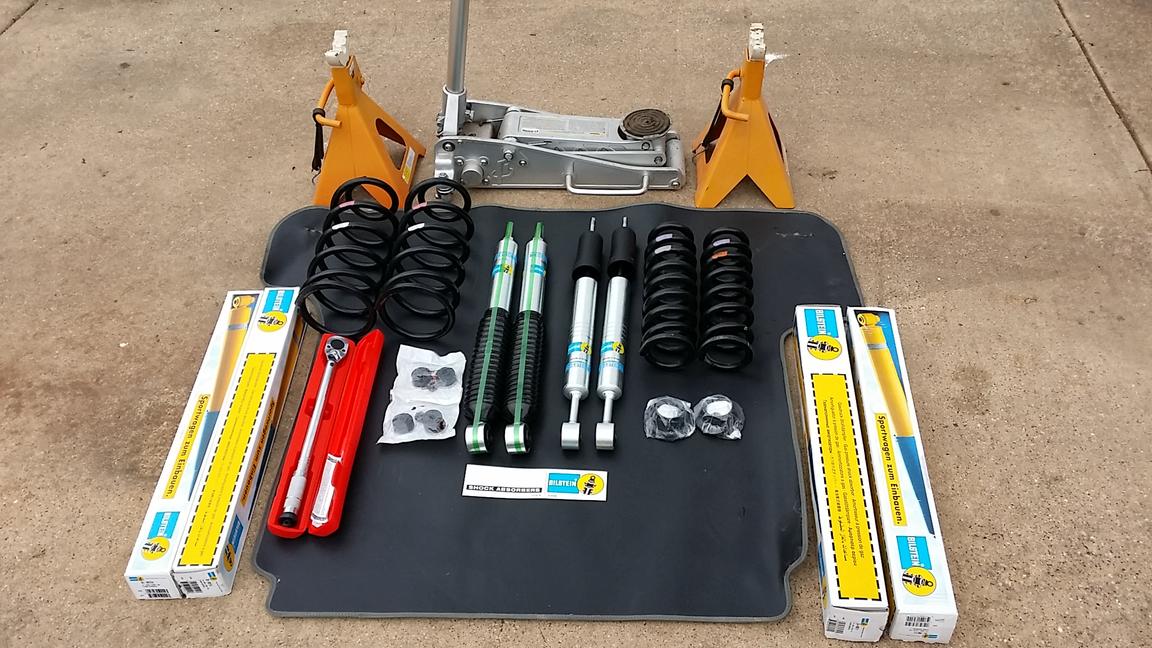

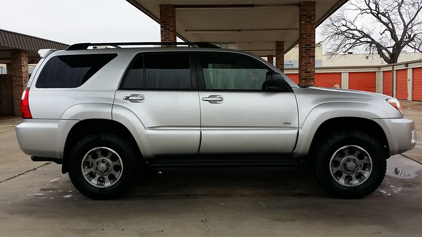

Thanks for all the input in doing an FJ swap, coils and shocks installation went smoothly.

Looking good! V6 or V8? 2WD?
07 SR5, V6, 2WD, 83k miles
2012 Front Coil Springs w/ 20+k miles
2013 Rear Coil Springs w/ 2k miles
Front Shocks Bilstein 5100 (24-186711) @ .85
Rear Shocks Bilstein 5100 (33-187174)
Wheels - 2013 FJ Cruiser 17" Wheels
Tires - Nitto Terra Grappler LT265-70-17
With new coils, shocks and bigger tires, front is up 4" (36-3/4") and rear is up 1-1/2" (37-1/8").
I pull a trailer every once in a while so I decided on the Nitto TG LT's since the P's max PSI is only 35.
I considered Duratracs but a coworker put them on his F150 4x4 and his MPG dropped by 4-5mpg.
