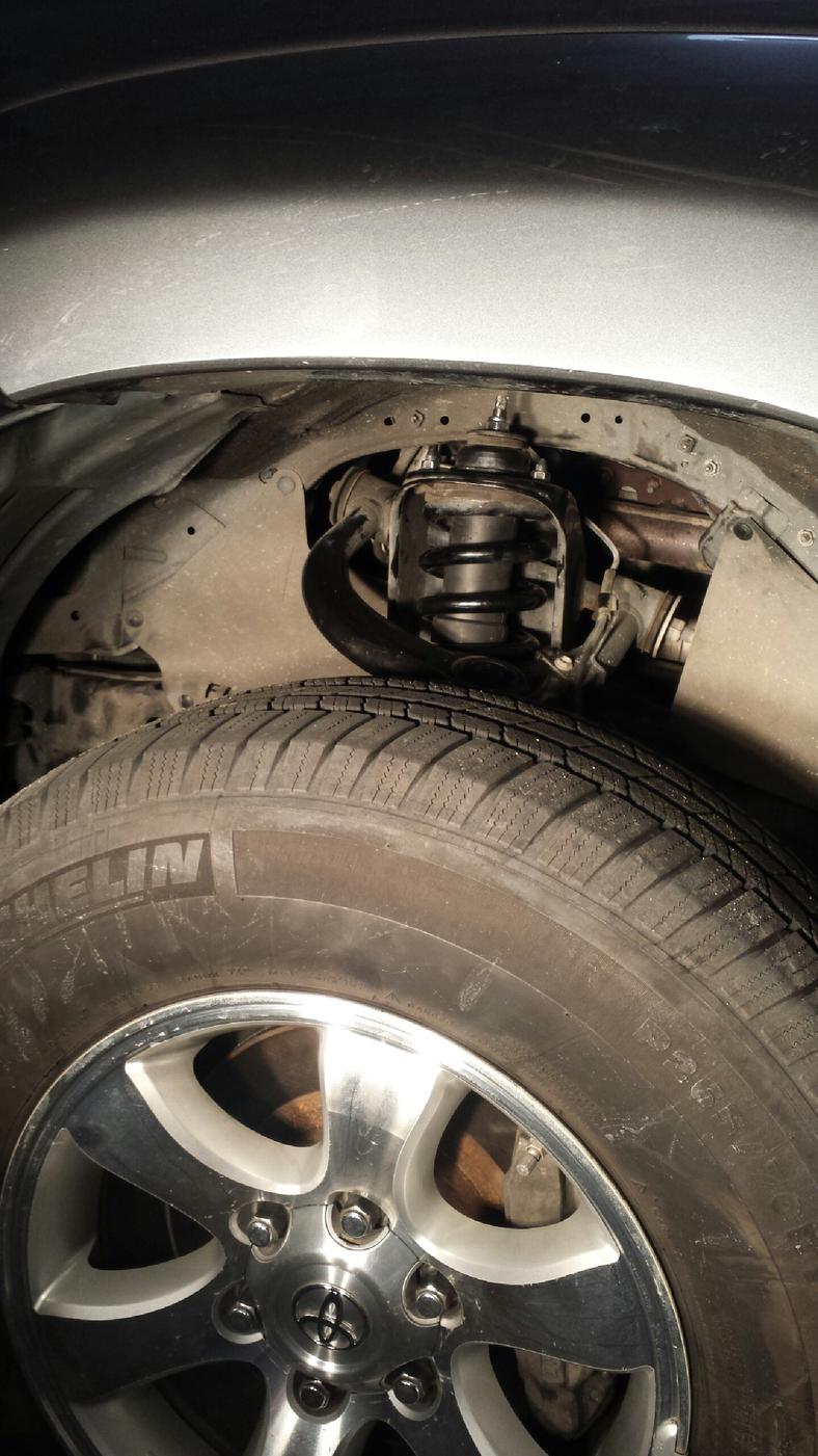

Hello everyone, I've been looking at the forums for about a month now to help me with shock replacement and I have a very strange issue. I have a 2007 Sport. It had stock XREAS setup for 113k and I decided to get rid of XREAS and go with Bilstein 5100 front and rear with stock springs. I change the rear first and everything went quick and smoothly. For the front I took the stock strut and the new Bilsteins to a shop to have the springs swapped. I didn't feel comfortable compressing the springs myself. I got the springs changed out and I then reassembled everything in the front and I tightened all the bolts while it was in the air without any weight on it. I noticed the front was very high compared to the rear. I double checked everything and didn't see anything out of place and thought it will be fixed after it settles overnight and while I drive it to the dealership for an alignment the next day. Well I get to the dealership and nothing had settled and they took a look and told me the shocks that I used are too long.
This is what I ordered and put on the front at .85 which is the second notch from bottom. After reading what everyone had done I decided .85 was a good setting.

I then I saw some threads say that the bolts can't be tightened unless its on the ground with full weight. So I raised the front. I loosened all the associated bolts. The only bolt I didn't touch was the middle bolt on the strut. I'm not sure if that will help or safe to loosen. I drove around the block very slowly to let it "settle" and I didn't see a single difference. So now I'm not sure what could be wrong.
Here are a couple of shots of what it looks like.
f5PTRmL,Itmibrg,QEWyk77
Any advice is appreciated. Thanks

I'm a little confused as to what your issue is. The billies can be used at stock height with no issues. You do realize that the rear shocks will NOT give you ANY lift without lift springs, yes? The front at .85 Should leave you with a slight rake.

The issue is that the front is too high even after all of the things I've tried.
Here is a direct link to the images, I can't seem to make the built in uploader work.

How about some pics of the spring perch on the bottom? Willing to bet it's upside down.
Ah, ETA - saw your pics. That's the issue. take it back to the shop and scream at them. The perch is 100% upside down.
