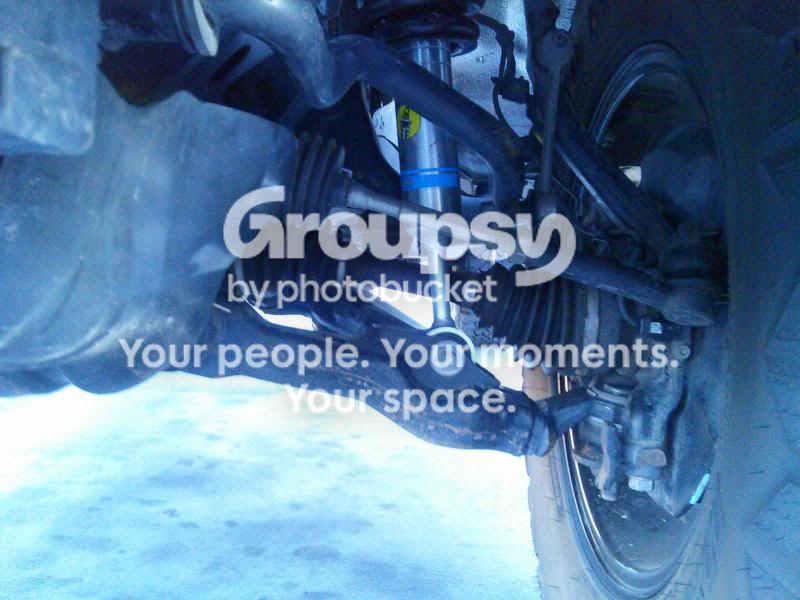

Do the angles on my cv's look acceptable?
How much lift are you running? Doesn't seem too bad to me.
I was one of the unlucky ones in that I got less than .25" lift out of the FJ springs so I'm right at 2" in front, stock in back.

Moog FJ coils , [email protected], and day star 1.5 in rear:behindsofa:
Figured that was coming. Based on my measurements, you're at 4.5" lift (angles don't appear to bad for that amount of lift). Have you actually measured? Are you running stock UCAs?

Measurements are 23 inches front and 24 inches rear, the ride feels good on and off road, I took it off road today no bottoming out ,I like it. as long as the cv's look ok that's what's important.
