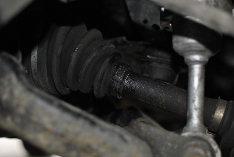

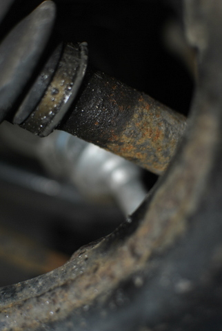

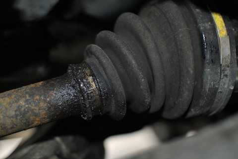

CV Boot (One month past lift)
So it's been about one month (~800 mi) since I put in my Toytec Lift:
The CV boots seem to be leaking from the clamp joint. Luckily, I was not able to find any tears on the boot anywhere. Also, it only seems to be the inboard boots which are affected.
Although I doubt anyone is surpised by this I thought that I would share for anyone considering doing this, as it seems to be fairly likely to occur.
The CV boots seem to be leaking from the clamp joint....
This does seem like a common occurrence so what steps should be taken at the time of the install to avoid this situation?
