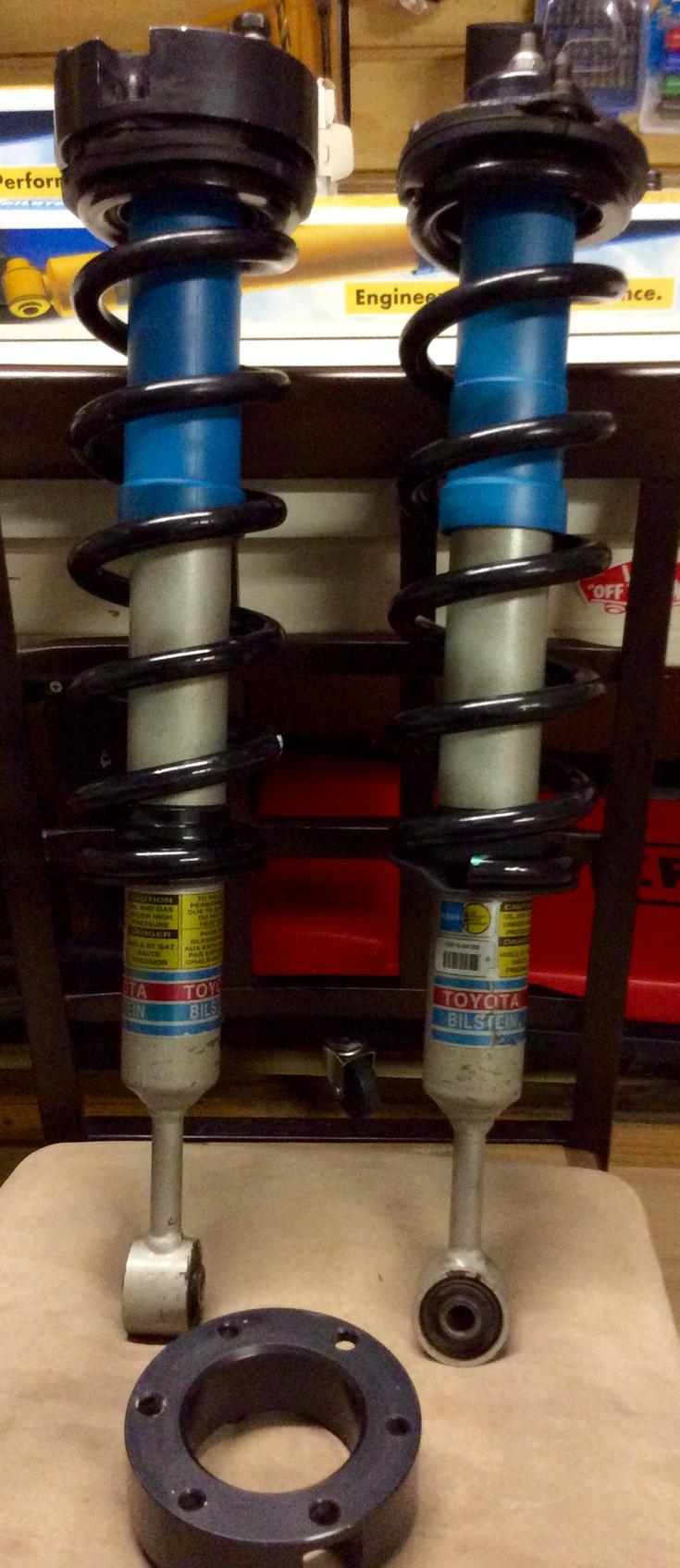

These FJ TRD Bilstein Struts? ...along with FJ TRD coils and 2.5" spacer pictured here. I ran this set right for like 10 mths and it handled good and and ride was comfy.
