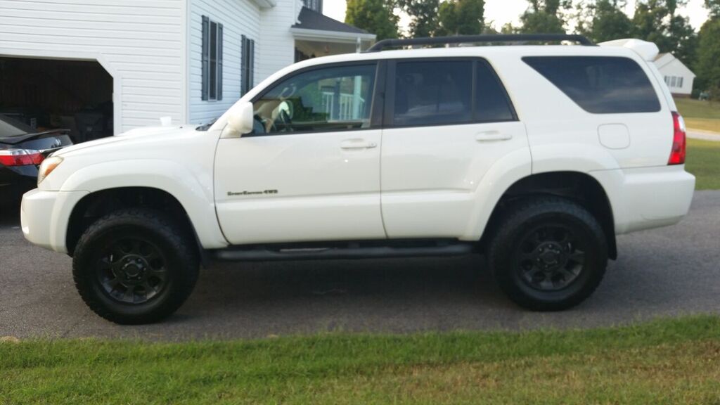

http://www.toyota-4runner.org/2117342-post3944.html
This was right after I finished installing the lift so it's settled down since. I can take some more pictures when I get home later if you want more angles. The tires look close to the mud flaps, but they aren't hitting. I was just off road with it twice this past weekend and there are no rub marks through the dirt/mud on the flaps or fender liners.
Nice rig! Thx 4 posting the pic! I assume the offset on your factory wheels is close to mine(+30mm). Are you running with or without spacers?
Looks awesome! Exactly what I'm looking to do... what do you have your front 5100's set on? 1.75? Thats the only thing I can't figure out... what does everyone running 5100's and 885's set them on to match a 2" lift in back??
5100s set at 0. The 885s provide all the lift to match the rear.
edit: Just saw you have a V8. I'm running 0 on the V6 to get a 3" in the front, not sure you'll get the same on the heavier engine.

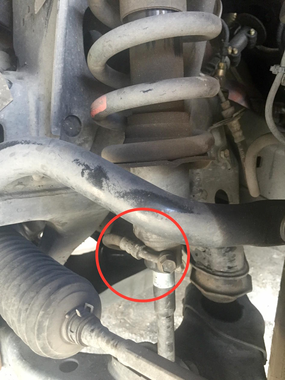

I am new to this and also not very knowledgable about cars and suspensions. I want to lift the front end a couple inches (level it out). My front struts are leaking, so I had purchased rancho quick lift coilers. But when going to install them, i found out that i have a hydraulic system in the front.
Does anyone know of any lifts that i can do to the front end to give me a 2" or more lift on my 4Runner.
(Here is a picture of the strut with the hydraulic)
You have the XREAS system. You shocks are connected with those tubes which means you have to replace all 4 at once. You can use any aftermarket shocks basically, but you have to do all them.

You can use those in the front, UT you need regular rear shock whether they are from Rancho, bilstein, or whatever. FJ shock fit too.
You will not be reusing those tubes and can unbolt them after replacing the shocks.
Look up the XREAS system here on the forum. There's several very informative threads about it and how to remove it.
