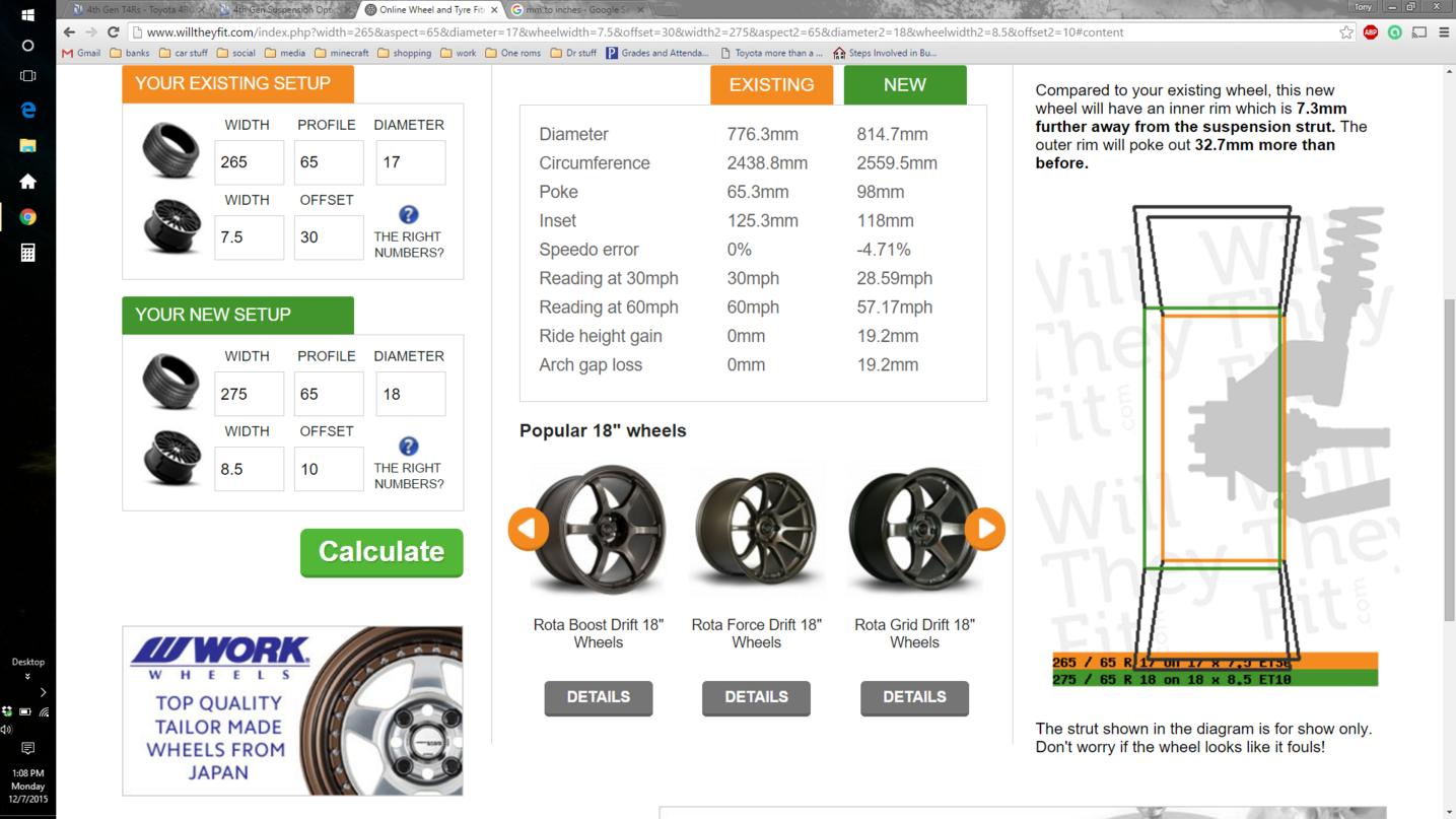

I am looking at Enkei st6 wheels in the following size with 275/65/18 tires.
Any able to comment on fitment?

Here's a screenshot of what it does. Will be 1.25 inches wider than stock, close to stock fitment on the inside of the tire. You may need to trim the body mount, but you won't know until you put them on. Also I'm sure there will be a slight need to pull that stupid fender liner forward as well. I don't remember what you have done already.

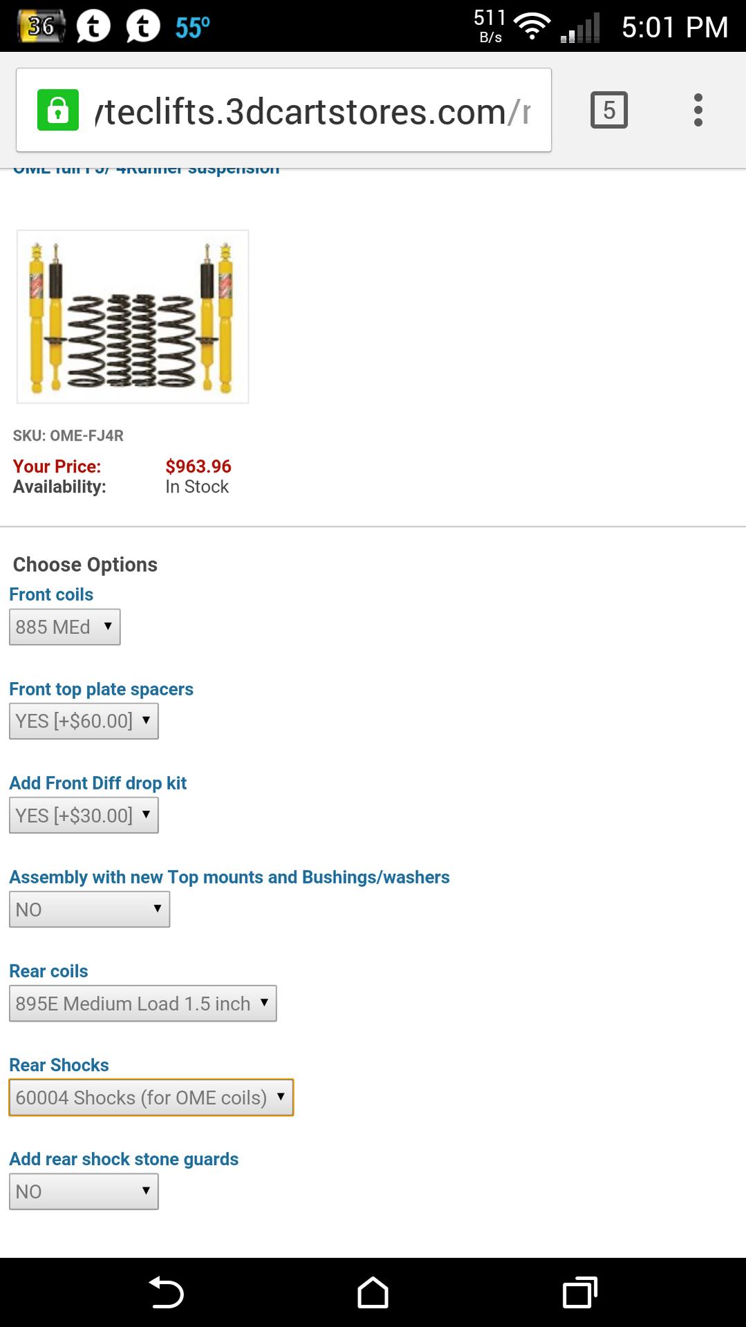

I was looking at both Toytec and OME complete kits just to make things easier:
Toytec
OME
Is there a major difference in off-road capability between these 2? I think I was leaning more towards the toytec kit.
