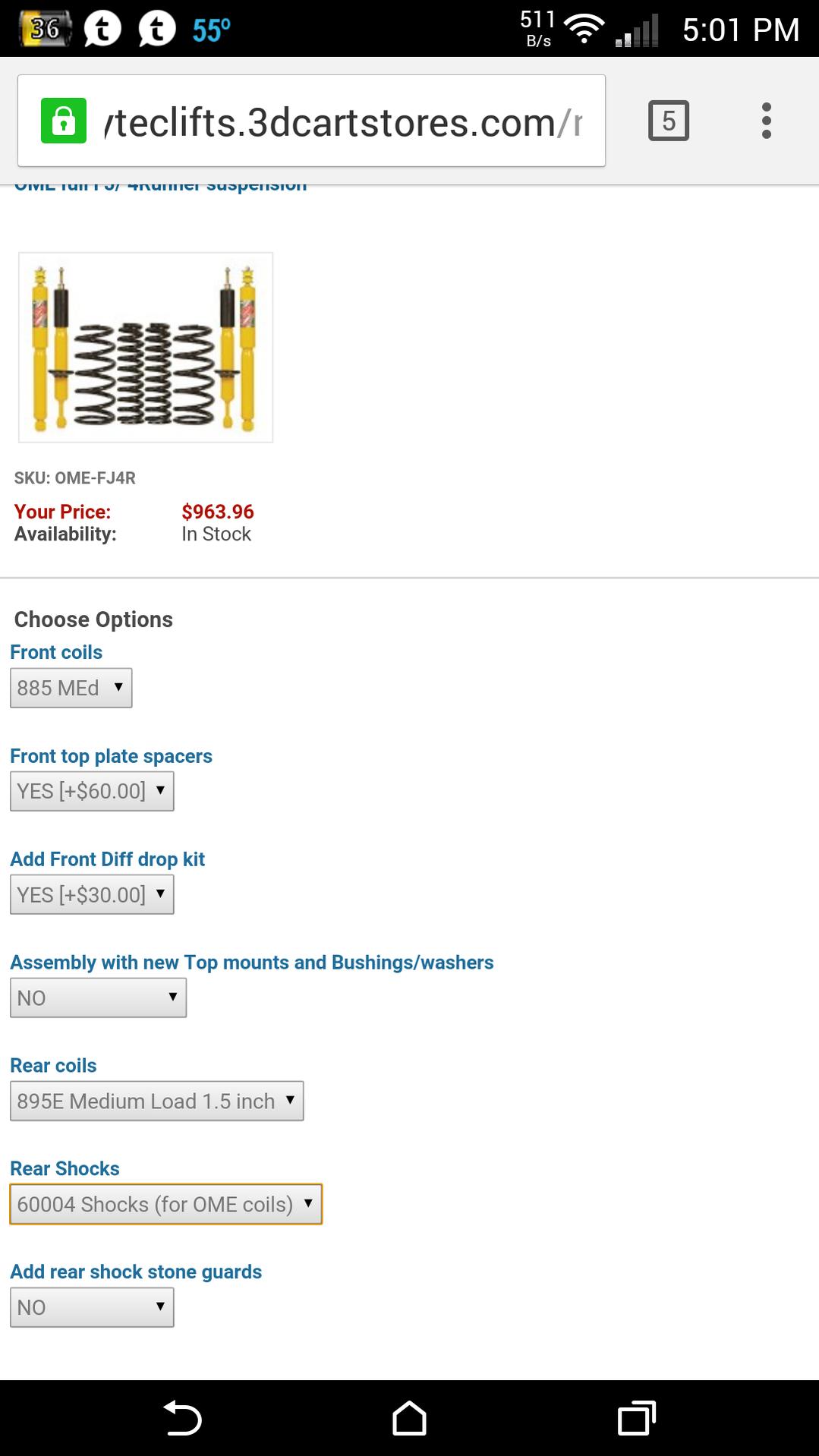

What do you think about the diff drop? Is it a good idea to get it? a lot of people seem to swing one way or another on here with suggesting it or not.
And is there a specific reason you chose the 885 instead of the 884? I don't plan on getting a replacement bumper anytime soon, and if i end up getting one it probably won't be for 4-5 years anyway.

You don't need the dif drop, I just look at it as a cheap safety measure. Won't be an issue unless you add spacers to that. I chose the med spring because it will help with hard jounces and such. Mostly if you decide to go faster in the desert it will help a ton. Best of both worlds situation.
Depending on the weight of the trailer you may want to get the heavier springs. I tow an enclosed trailer, approximately 5800lbs, and I sag even with FJ coils.

Ok, I'll probably end up going with the one you linked then without the dif drop. Med spring sounds good, my trailer is only about 2000 lbs loaded.
What are the "Front Top Plate Spacers" that cost $60?

Here's a link to a good thread about OME. http://www.toyota-4runner.org/4th-gen-t4rs/211170-old-man-emu-springs-shocks.html
The spacers give you a full 3" of lift which isn't a bad use of the $60.
