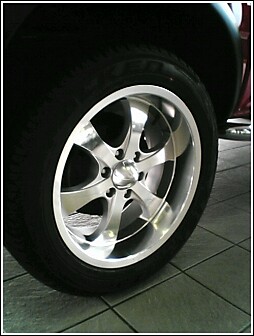

So I got a new 2004 4runner since my 03 was totaled in the Hurricane (charley). And the new 4runner has these new tire pressure sensors. I want to add the sensors to the new rims and tires.
The problem that i'm running into, from what i understand, is that the valve stem is connected to a sensor inside of the rims. No I've heard 3 different stories.
1) the valve stems and sensors will not fit the new 20"
2) If I put on the new rims without the sensors my tire pressure light will never come off my dash.
3)or, from a toyota tech, that the sensors in the new rims will throw off the speed sensors and the tire pressure sensor and my truck will be all out of wack.
Can any here help me clarify which is true if any before I replace these rims on Wednesday.
I know many of you have limiteds and have had these sensors for a while. Alos many of you have changed your rims or lifted your truck, what did you experience?

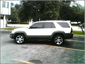

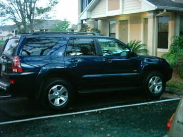

Here is the new runner. It will look much better. Simply because they are 10" wide rims. With the offset, the tires stick out about 1.5". They look really beefy.

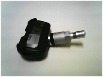

The stem has a metal washer on the outside and rubber on the inside, so it still leaks air out.
The spare does have one on - there is a thread somewhere about a mod to add a hose to allow you to top it up with air without taking it out from under the truck and it mentions people getting a warning when the spare lost pressure. If you get the dealer to remove the stem on the spare my guess based on this thread is that you should be ok.
Yeah take it to the dealer and ask them if they can remove it from the spare or disable the system. I just put new wheels on my Runner earlier tonight and the stems went on without a hitch, no lights or anything.
