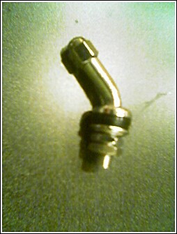

I know this is rehashing and old subject, But i just wanted to let you guys know that i got my sensors on to my new rims. I' ve had them on there for a few weeks now and have waited to see if there were any leaks, but there are none. I found a set of valve stems from toyote that came with larger rubber washers. Actually they are really nice chrome valve stems.

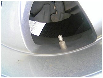

The part number for the new stems is 00016-34103, it's like $14 for all four. I took the rubber washers from this stem and used to replace the tiny rubber washer origianally on the Tire sensor. Then I tightened them on with the original washer and bolt cap on to my 20" nad they work perfectly.

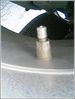

I think this is something that some of you can use for those of you looking to change you rims and keep the tire pressure monitoring system.
Looks like the 20" wheels need a different v/stem.
2K34R,
Just to clarify. Did they remove the old stems from the sensors and attach them to the new stems?
