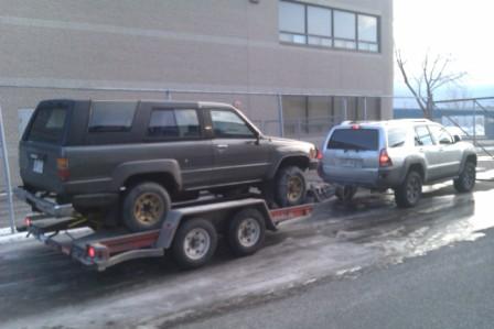

I'm not a regular tower. But I've towed probably 6000 pounds 3 times last year.
Uhaul says their car transporter is 2000lbs and I'll say 1st gen is probably about 4000lbs.
Uhaul recomended Max 55/hr. And that is pretty acurate. The 4runner can do more, but the trailer got wobbly. But I think that is more a function of the trailers suspension and tires. With a better trailer, it will probably do better. Even at 55 though I felt in control. Except the first time I towed it was my very first towing experience so I didn't know what to expect, at the end of it, I got the feel for it.I think the key to all this is the brakes on the trailer. Without brakes it would be impossible. Even though the uhaul were just surge brakes I really felt them doing their thing.
I can also say that on the flat surface where I loaded, once it was in gear and my foot was off the breaks my 4runner advanced without me pressing on the gas. I did this with the standard hitch. I know. Toyota does not recomend it. But that hitch is capable. When you are driving and you hit a pothole, or go uphill or down hill, take a curve etc...I would say that the weight shifts and more forces are pulling and pushing it than just the 5000lbs would be. But before I do it again. I am going to go get the hitch that bolts to both sides of the frame.
Gas wise, I did 14-15L/100Km normally, and then did 17-18L/100Km. For additional comparison, if I drive "sporty" I also do 17-18L/100Km.
For very long trips, some people have recomended installing a larger transmission cooler.
For the Diffs. Not feeling anything weird.
I do have an OME medium coils. Not sure if that helped or not. I would think it did. So you would need better weight bearing coils or airbag helpers. Or put more of the weight further away. But there too, you don't want the weight pulling up the rear end of the 4runner either.
Pulled out of this parking lot, on a sheet of ice. Not problem. barely pressed the gas. Not slipping. Basically, awesome.
