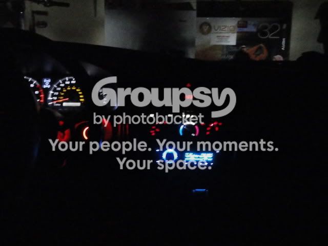

Heres a breakdown of the bulb sizes from [MENTION=57546]4-Ripcord[/MENTION], hope it helps.
LED Interior conversion.
Many drivers don't like the green color of the interior lights, that can be fixed. The lights behind the dash, center console, key ring, map lights, and dome lights can all be changed
Here is one excellent example:
clockcolor015.jpg~original
Photo courtesy of GottaBeTRD.
http://www.toyota-4runner.org/3rd-gen-t4rs/78310-led-conversion-questions-2.html#post870257
