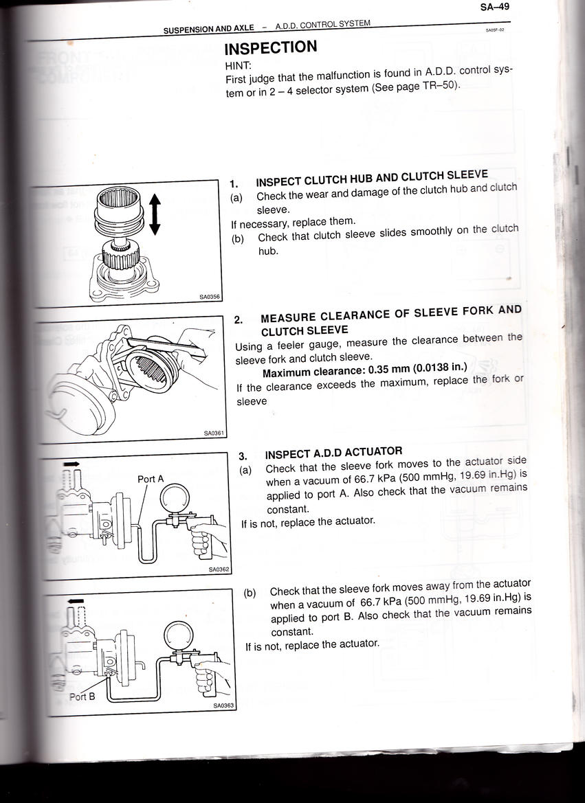

Matt, it sounds to me as though the problem is in the actuator, perhaps in the clutch. There is very little on the actuator in the FSM, but I am attaching what there is.
If you have a healthy vacuum and it switches sides as it should, I don't see how the problem could be anywhere but the actuator or possibly the diff itself.
This is from my paper '99 FSM which covers the vacuum actuator, unlike the on-line FSM which only has the electric '01-'02 version.

Are you using Port A and B as shown in the FSM page I posted or the actual hose tubes?
I used the tubes, but I replaced both tubes with brand new ones when I did the service.
