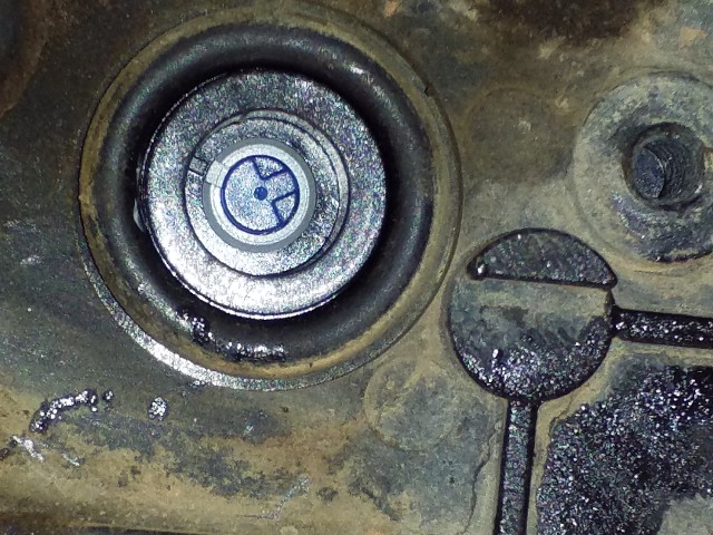

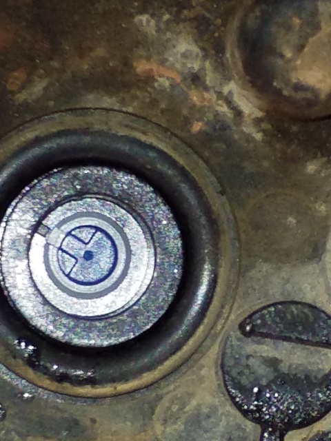

I have a plate you can remove and see the blue dial with the cover on.
Figured I would post pictures here.
This is with 2hi.
This is 4hi and 4lo

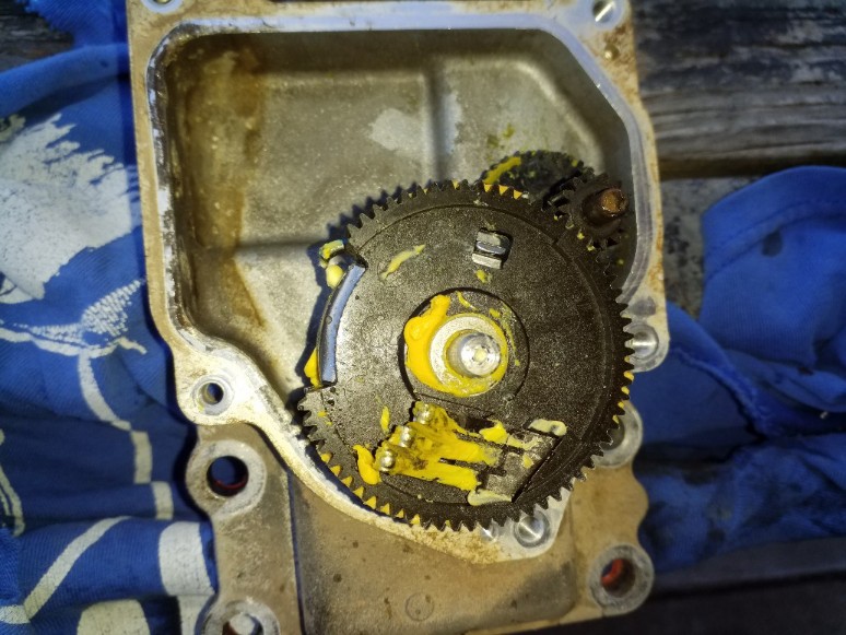

Opened the cover and the dial section is mounted to the cover, not like what i have seen or misunderstood other post, no pictures of it on there post. It also has a long plastic section that was keeping me from completely removing, didnt want to force and break things.
On opening it and what visual I could do, no water came out, no signs of water getting in, and all gears greased.

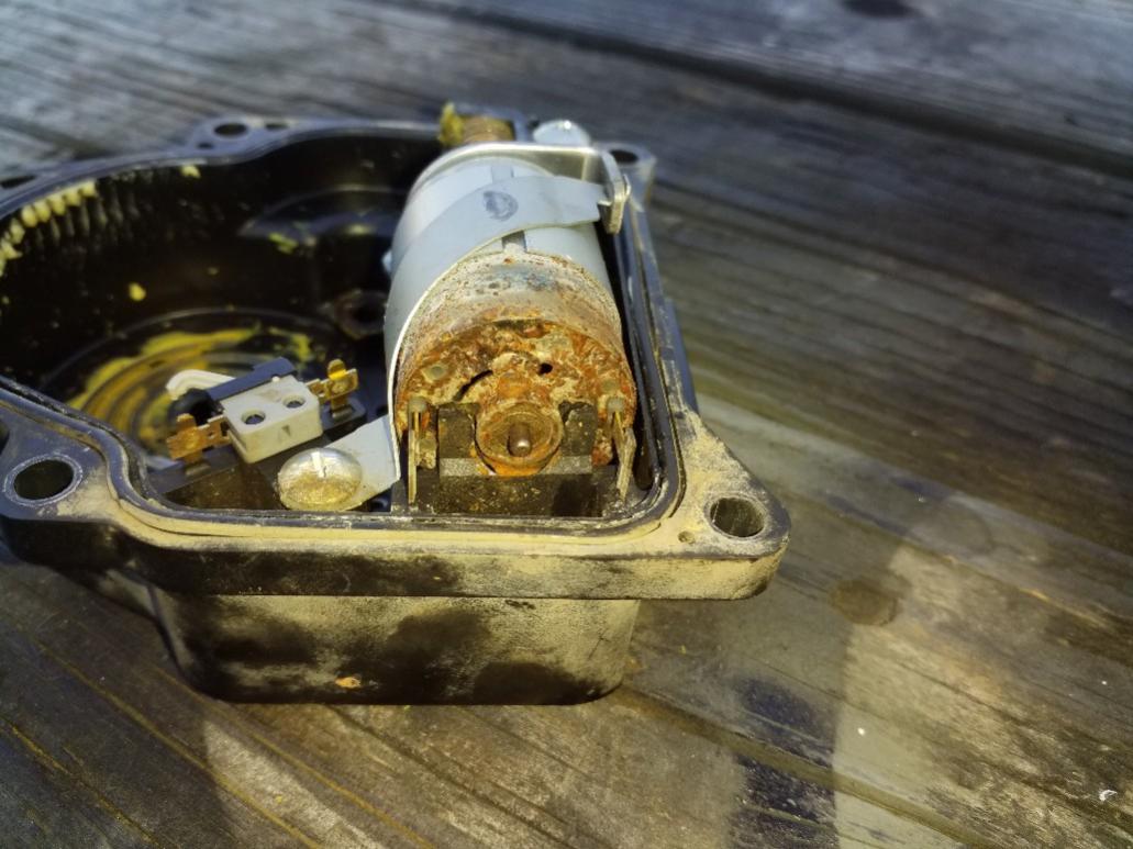

When I opened the rear, all the motor area was shiny clean motor. The front, was no signs of where water/moisture was entering.
My thoughts, with part of the housing of the actuator being metal, it creates a condisation in there. I found a pinhead drop of moisture.you can see a drop on 1 part on the grease. So as I used a blower, you can see moisture coming out from under and around the motor unit. You can see how they install these motors to just make contact on the leads. I did a solder on these as I was in it and regreased things.
Will see how this worked for me, and seeing the motor, might be replacing the front in due time.

Hi. I opened the ADD actuator. Gears fell out. I do not have the experience to assemble the gears. Any help appreciated.
