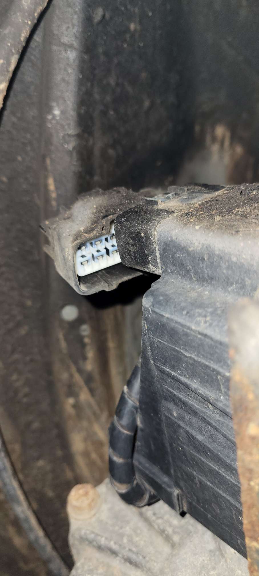

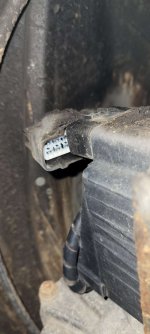

Well I'm no scientist but I'm going to go out on a limb and say this should probably be plugged in...
After doing that it sounds and feels like it's trying to engage but still won't. I'll keep trying and give it some love taps with a hammer - where's the best place to hit it?
