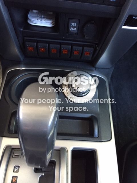

Following is how I mounted the switches that came with it (you can get green or blue lights, not just amber):

My pleasure.
If you have a 2014 to 2016 4Runner, then a 6-switch bank will fit in the large hole of the cubby with only minor modifications. You will only have to:
1) File/dremel the edges and corners of the switch bank. I used a OTRATTW switch bank. Here is a link to Engineer's thread.
2) Drill a 1/2" hole in the back of the cubby to run the SPOD wire harness through.
I then used some double sided tape and pressure fit switch bank into the cubby hole.
If you have a 2010 to 2013 cubby (the one that comes with a door), you will have to do some major cutting to the cubby. I have a 2013 4Runner and I actually purchased the 2014 cubby from a fellow forum member just so I wouldn't have to do any major cutting.
As you saw in the post above, another forum member mounted it in the sunglass holder.

Center cubby or spot just in front of shifter is ideal for switches, having done it the other way myself, you can see my build thread for pics of how I mounted and my switches. I have some AOB and a 3 panel contura switch plate.

If you use the 2014+ cubby-hole (the one w/o the door) the fit only requires minor trimming to the switch plate bracket along the corners. If you are using the 2010 to 2013 cuby-hole (w/ the door) you will likely have to cut into the cubby-hole itself.
Here is the link, to Engineer's site that describes the minor trimming involved on the switch plate. You can use double sided tape to keep the switch plate in place.
