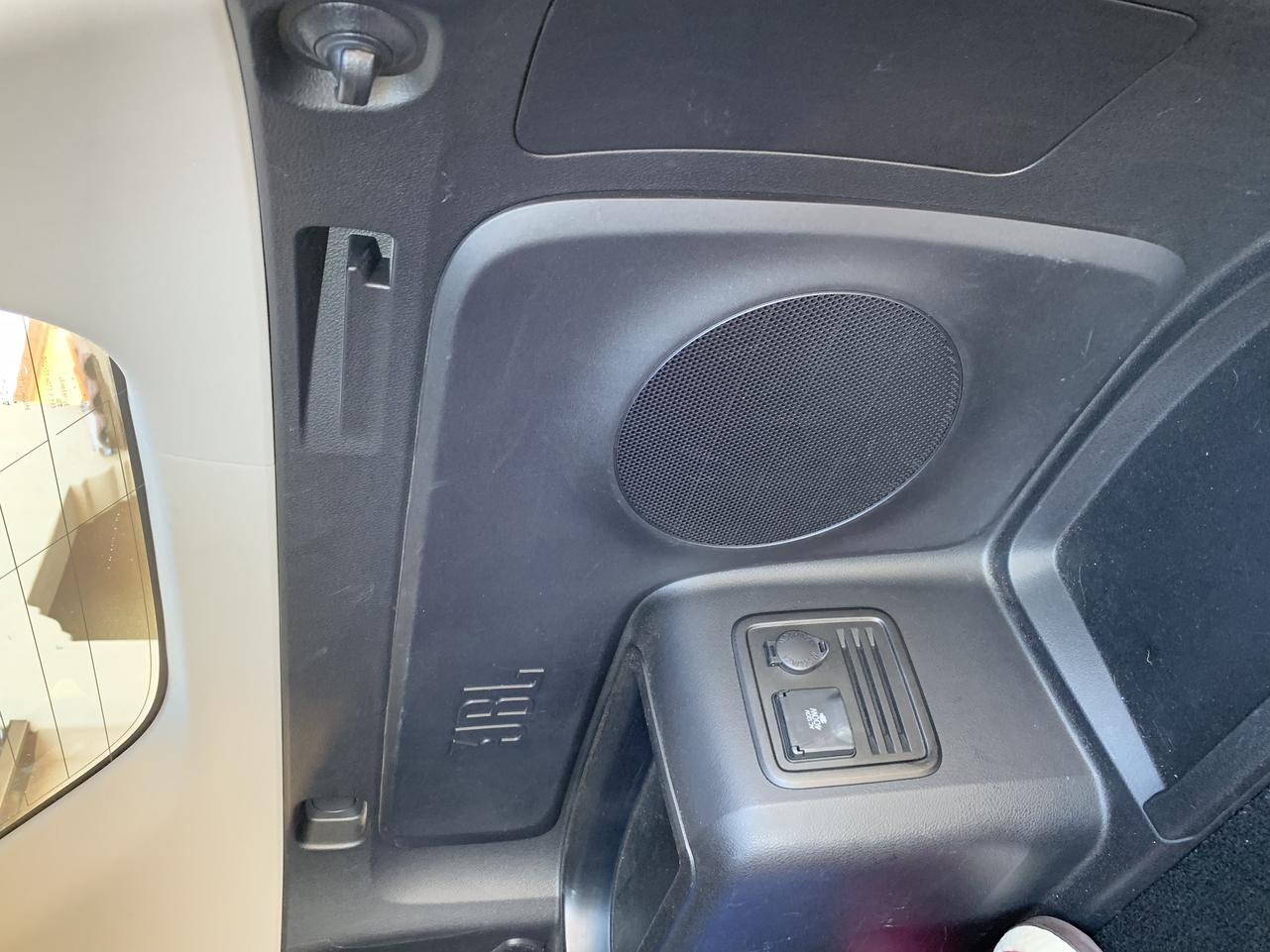

Somewhat similar question. I need to replace the JBL sub in my 2014 but don’t know how to access it and the amp. I have seen pictures and videos but they are slightly to very different than my set up. It appears that the cover can be removed by working it off with a flathead but I don’t want to risk breaking anything. Is it that simple? D31AC1CD-43DC-4C9B-B1B0-FA482DB7CD9A.jpg
Thanks!
Somewhat similar question. I need to replace the JBL sub in my 2014 but don’t know how to access it and the amp. I have seen pictures and videos but they are slightly to very different than my set up. It appears that the cover can be removed by working it off with a flathead but I don’t want to risk breaking anything. Is it that simple? View attachment 316495
Thanks!
Here’s a good write up from 97BlackAckCL http://www.toyota-4runner.org/5th-g...cess-rear-panel-pocket-subwoofer-install.html
