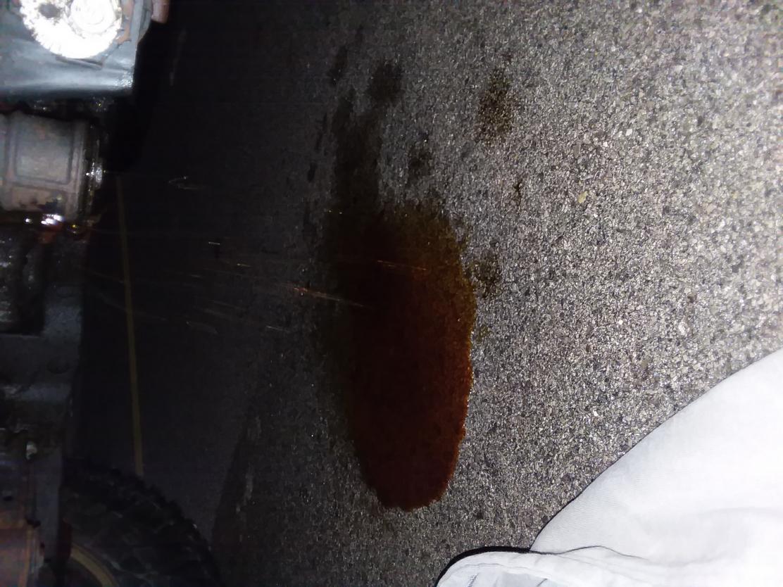

It was the filter.
I started it up at work and oil poured out from what looked like right below the filter. I went and bought another filter and the leak stopped.
I believe there was dirt on the filter gasket because I felt some on the mating surface of the block. I cleaned it real good and fished the new filter through from above.
I hope no damage was done running it however long I did with very little oil.
Thanks for all the help.
Picture is of the leak during first start.
