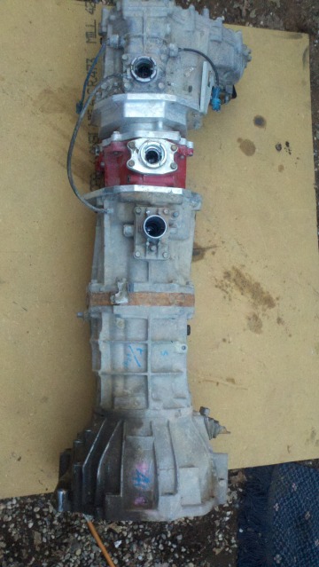

Here's the set up.
Complete dual transfer case setup:
*inchworm dual cases
*inchworm v6 5 speed to 4cyl plate
*marlin 4.7 xd 23 spline gears
*heavy duty detent springs
*inchworm shifter top plate
*all is mated to a stock 5 speed and tcase
*marlin eco seals on transmission and adapter plate
*4x innovations polly trans mount +stock one and stock 4cyl mount.

4.7 in the crawl box right? I am doing duals soon. I just need the adaptors. Debating on the 4.7 gear but I'm for sure twin sticking it.
