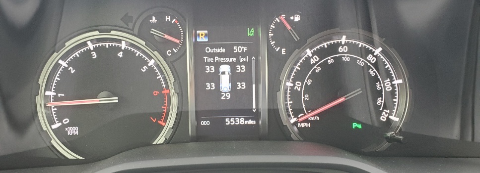

I have a 2020 Limited and it has 5 TPMS and displays all 5 pressures on the dash. After doing some research, the 5th TPMS seems to be only available on the Limited models.
Yeah I use a scanguage to monitor pressures via the obd port. Only gives me 4. Spare looks like a normal rubber valve stem.
