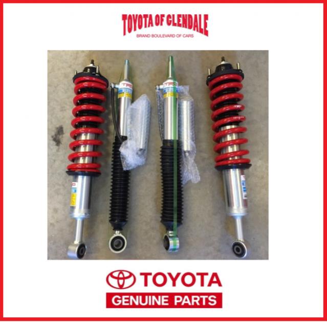

forget the maintenance have him install this...:clap2:
