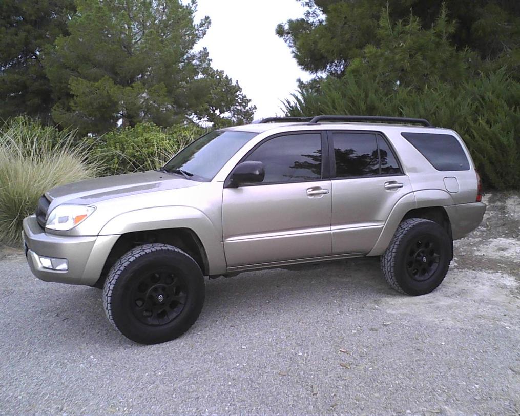

5100/FJ Springs FJ Wheels Cooper Tires Done
Looks great. I got those same tires and size before taking our trip to Colorado. They worked great and glad I got them. Total of 2700 miles and very solid tires. I installed basically the same set up on the suspension. I was very happy as most seem to be with this installation.
Any major Snow time and how did they handle the powder? Ya I really like the tires as well and lookin forward to the White Stuff in Northern Az.
Got the Cooper's in the Powder.
Finally got up to Flag and played in the Snow. Coopers performed great in the Snow. Very good tire and glad I picked the ATP'S. No issues at all. Going back soon to play some more.

No Rear spacer. I have just the FJ Springs and 5100's all around with the front set at 1.75. I thought I would be Nose high a little but it settled really nice. The ride over the Stock X reas is night and day way better. I looked at alot of rigs at .85 and 1.75 before choosing 1.75 up front and glad I did. I love the look and stance. Thanks for the compliment. :drum:

Thanks bro you too ! Took some time like you looking at these tires , and really am having good luck so far . Was a little worried that the spare wasn't gonna fit but it did whew , was not looking forward to putting in on the roofrack . Anyway as the Mon said me belly full

Buy them. And just to add that without the generous support and help of so many here my Rig would NOT be what it is today. Starting with a link to factory LED Tails for a great price, and it took off from there. I NEVER would have put my headlights in my oven. The FJ spring 5100 combo rides great and the '12 FJ Wheels look Sweet. The debate between .85 and 1.75 was solved by looking at a ton of Rigs set at both. Man am I glad I went 1.75. Looks so much different now than it did a year ago. Thanks to all for the help. Ark thanks for always leading me in the right direction and help answer all my questions. This vehicle is the smoothest V8 I have ever drivin. Looks like Flag is gona get some more Snow here soon. Yep...
