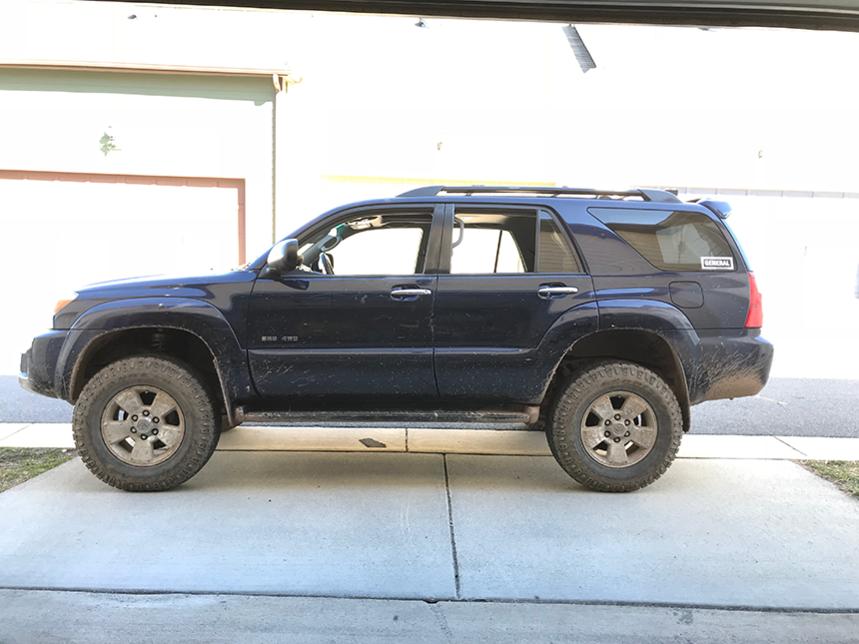

I don't know if it's much help or not.. but, when I got mine (had 155k on it) the springs and shocks were shot, it rode like an old caddie... sounds like you're looking at springs and shocks too.
Instead of sourcing parts from multiple places and/or installing used parts, I went with this: 3" Lift W/ Bilstein 5100 Front Coilovers. I've been really happy with it.

Good looking truck. Thanks for pointing me toward that setup!

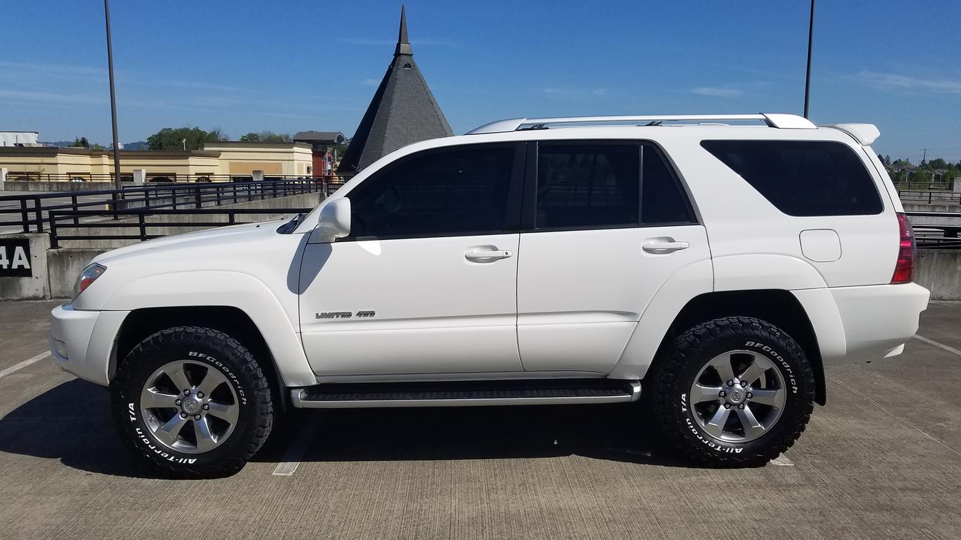

I just lifted my 4runner about a month ago. I wanted a mild lift. Bilstiens on all 4 corners, the front is set to the 3rd notch which is 1.75". In the rear I used a 1" spacer from burtmans. I used the original springs. I wish I would have used different rear springs tho. Mine are shot. they sag pretty bad when I have weight in the rear. will likely swap them out in the future. She shits pretty level right now.I like the rake look, so looking for something to lift the rear a little bit more, may look into some fj springs for the rear. Hope this helps.
