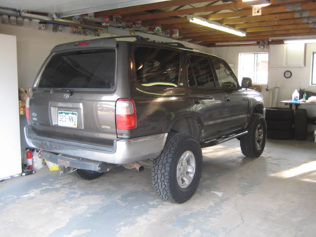

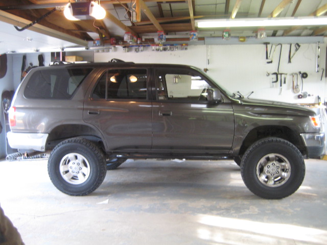

Great sliders for the price. Mine took a beating (took the full weight of the rig in a rollover) and held up fine.
