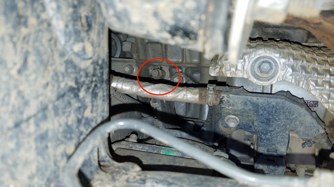

Looking through the driver side wheel well it's just behind the shock tower and over the frame rail. It's brass so it'll have a faintly gold color to it and a round "button" on the head. Kinda hard to reach - I pull the driver side wheel off (don't need to on the passenger side) then use a long extension with wobble. I think I use my 10" wobble extension on the socket then a 3" extension or two attached to that. See pic. Shock tower takes up the left third of this picture with the frame rail at the bottom.

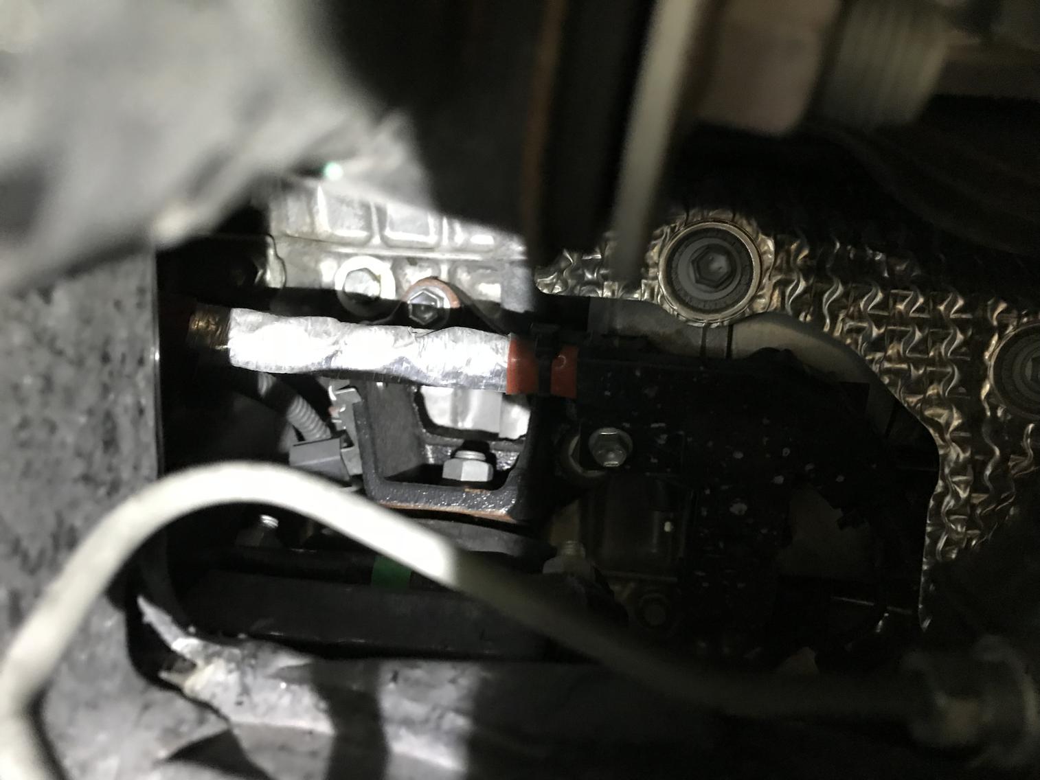

So looks like there isn’t a block drain plug on driver side on 2013 looks like a factory screw in that spot without a spout like on the passenger side.

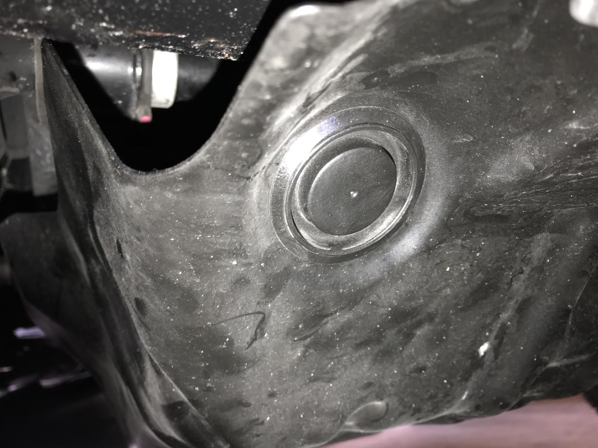

Few other things. If you open the cap on the overfill container and not the radiator when draining, the the container will empty out and you won’t have to siphon it out. Secondly, I didn’t have to drop the skid, I just attached a 15” clear hose to the drain plug on the radiator and fitted through a hole in the skid (looks like the hole is there specially for that). I’ve read online that some don’t bother with the engine block plug because not much comes out. Well, I definitely recommend draining that plug, I drained over a half gallon from there.
Thanks for the pic. If you look at my pic (2013) there is a factory screw where you have the drain plug. Looks like Toyota changed the design slightly. It has to be factory since I’ve had this truck since new and have done all the maintenance myself.

They did not change the design. they just changed the drain to a bolt. Probably to save a few pennies. The block is the same for sure.

Yeah, I knew they had eliminated that one at some point but I was thinking they did that later. Definitely worth draining from whatever block drains you have - especially if doing a simple dump and fill. If you do an intermediate step - dump it, fill it with water, drive around a bit then dump again and fill with antifreeze/water mixture - it's probably not as important.

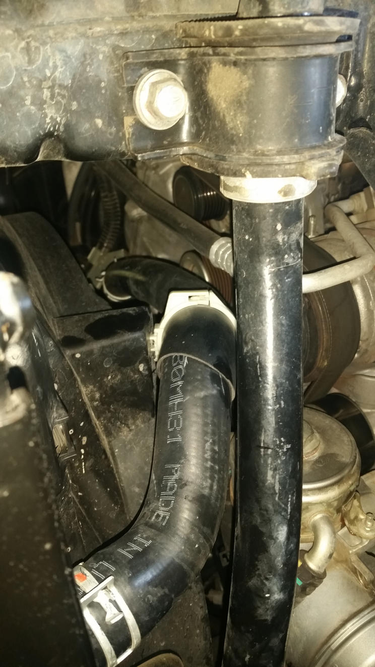

Changed mine today and replaced the lower radiator hose while I was in there. The clamp to the body slowed me down.

Yes - the typical engine block drain spout was eliminated in 2013 and access to the replacement "bolt" is no fun. If you did manage to get the bolt out, you might be challenged getting it back in.
