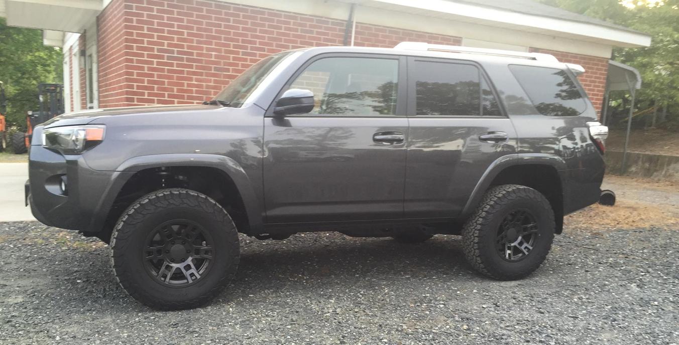

Yes that's what they're there for. Keep in mind, stock skids are just stamped sheet metal and can't take much abuse. If you plan to use them as skid plates, upgrade them. This is mine with that kit installed and a 285/70/17 BFG KO2 tire under it.

That looks very nice! I'm not trying to abuse skids, but on some of the "humps" it would scrape a little of the clay/dirt. It's a 3.5 hour drive for me to get some decent off-roading so it will not be a very frequent thing for me. So I'm trying to do some basic upgrades to protect my very expensive (to me anyway) 4Runner while trying to have fun with her. I was thinking either a lift or rock sliders as my first upgrade. I scraped my running boards once or twice.

Thank you. Yes the running boards do hang quite low. Sliders would be a good idea to protect the rockers. Skid plates after that, then a lift and bigger tires. If you do the lift first, you'll likely lose sight of how easily you can still bottom out and may end up damaging something. At least with rock protection in place, if you do scrape something, you'll be prepared for it.
