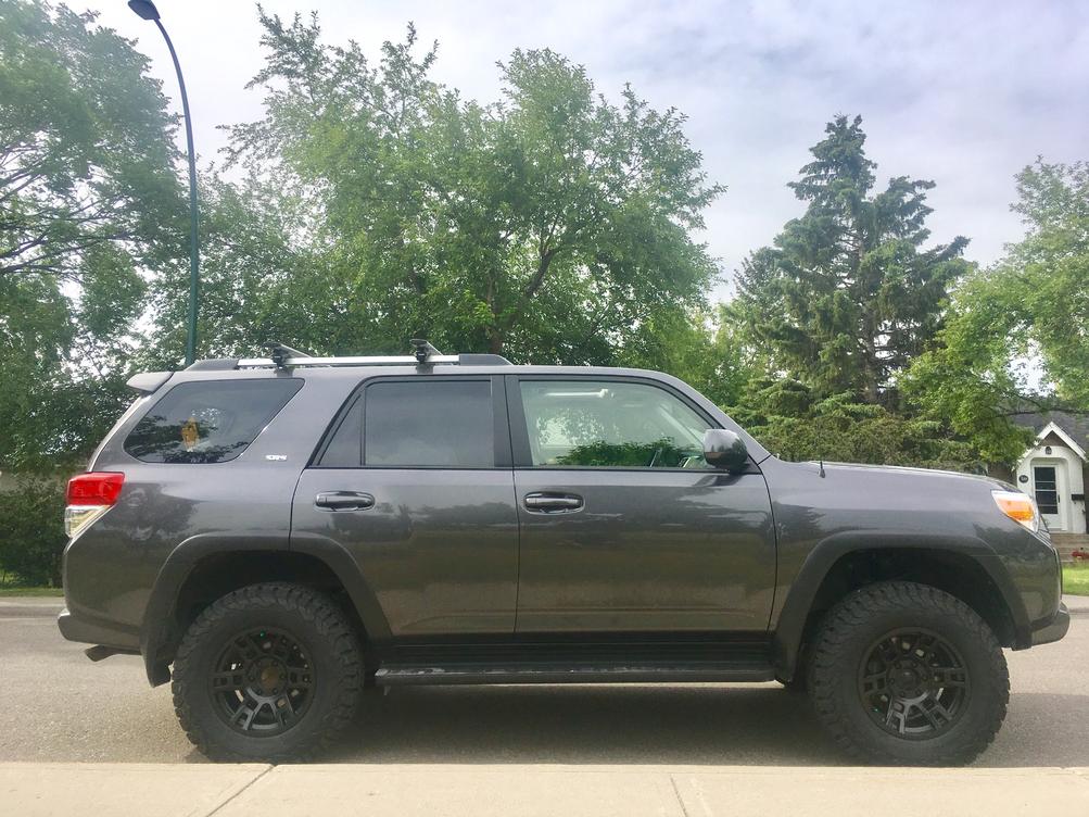

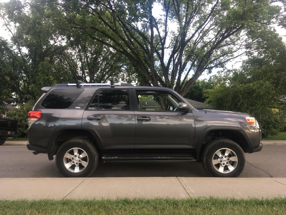

daystar 2.5/1.5
thanks again to everyone on the board.. tons of good info and photos of everything.
just got my cheapo daystar lift installed last night .... so far very happy with it. I thought long and hard whether to get full coilovers but frankly I will likely never reach the full potential of this truck offroad.
everything is stock except lift. alignment and new fx pro wheels going on next Monday!
edit - fx pros on!
edit - fx pros on!
Good looking rig! I've got some FN fx Pros on order, and I'm hoping to get a similar look/stance as what you've got - what brand and size tires did you go with?
