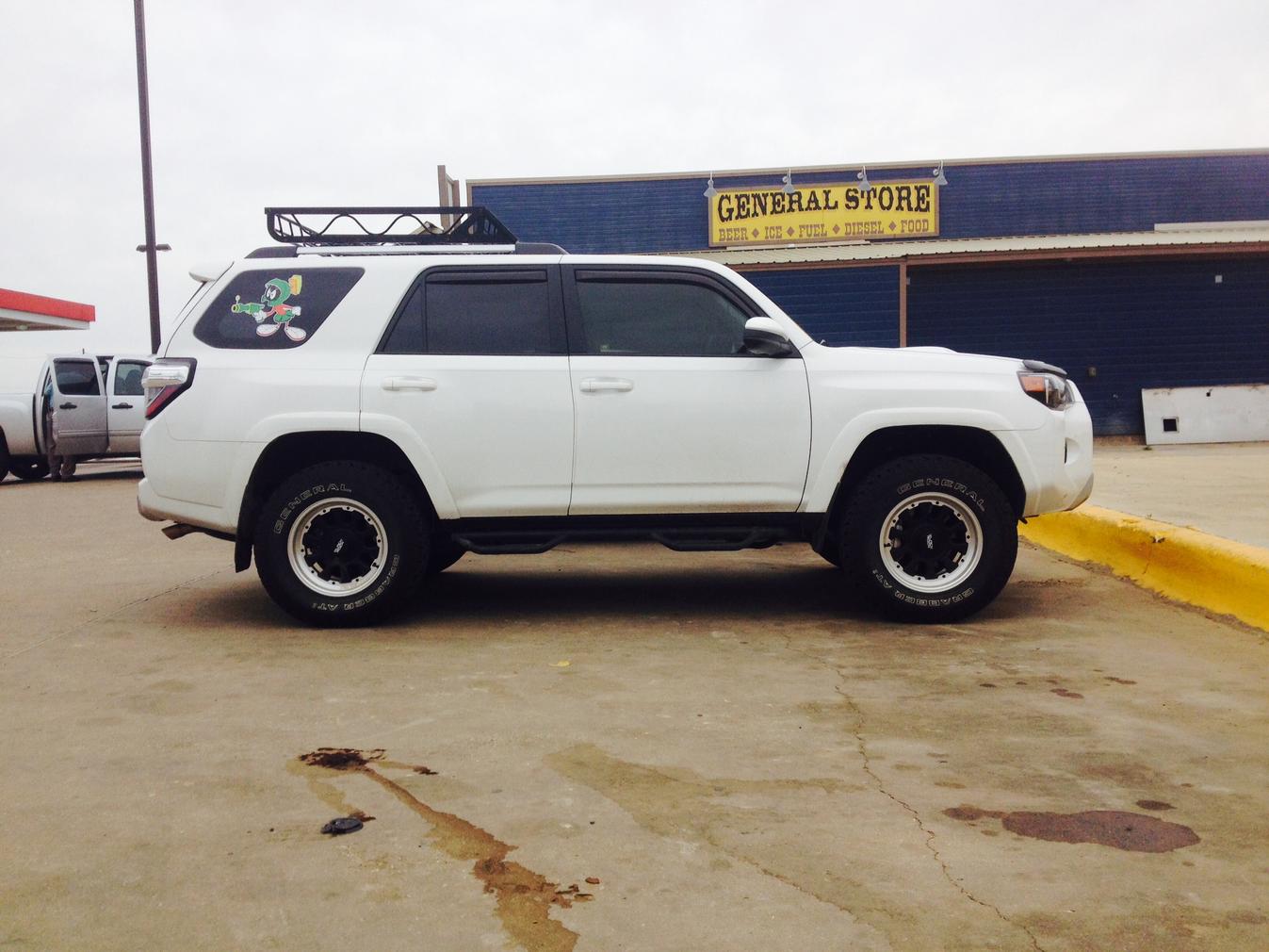

No and no. I started out with just four 5100's with the fronts bumped up to 1.75". I have since moved on, but you will be fine with just fronts and the factory springs as an initial investment. Mind you, you will need to limit yourself to about 1.75" in the front if you don't change rear springs and shocks. Or you will end up with a pretty severe reverse rake. The picture below is at 1.75 front with factory springs all around. And 3 years later I am still running 265's.

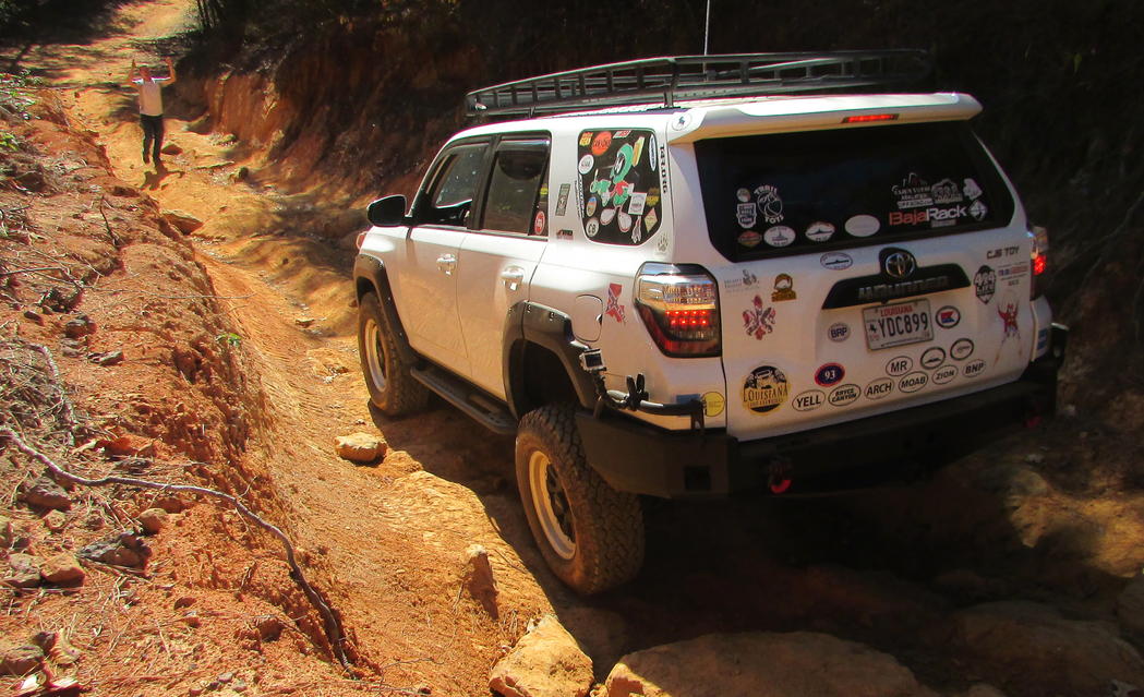

There is no adjustment for the rear 5100's. They are simply a little longer to allow for lift via springs or spacers. The only adjustment notches are on the front shocks. I have been perfectly happy off roading with the 265/70's I have stuck with. The added lift up front was helpful, but like you I didn't want to impact my mileage too much. I occasionally get pressure from friends in here to go to 275 or 285 tires. So far I have stayed the course, and I do some pretty fair to middling trails with no problems.

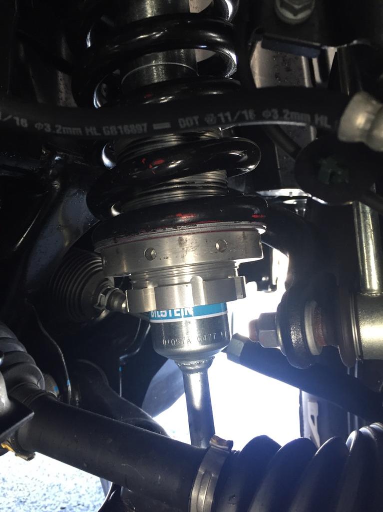

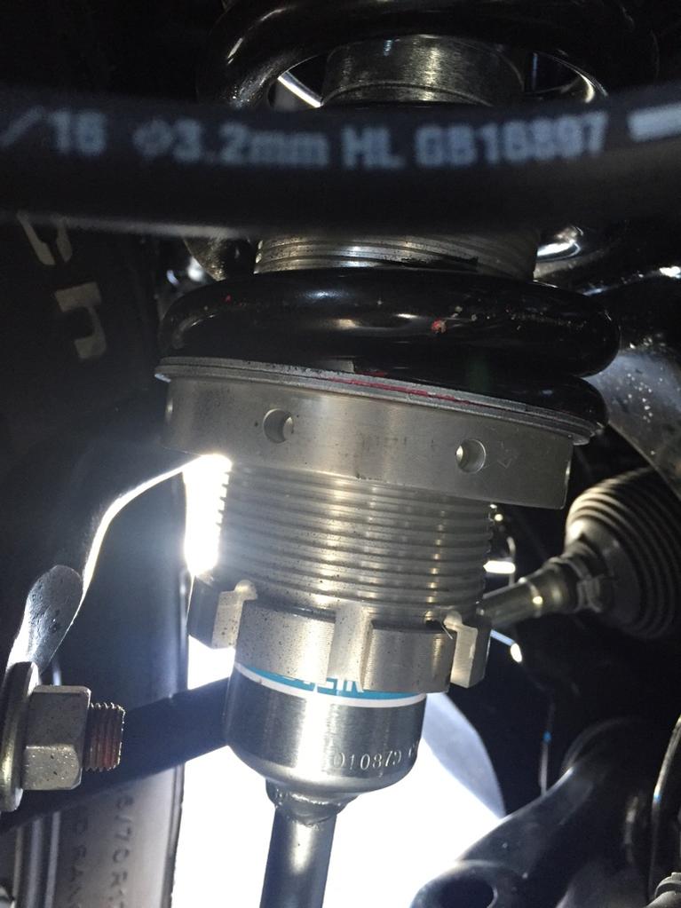

Installed my ToyTec Ultimate kit last night. Had to decrease the preload on the passenger side coilover significantly. Is this normal?
