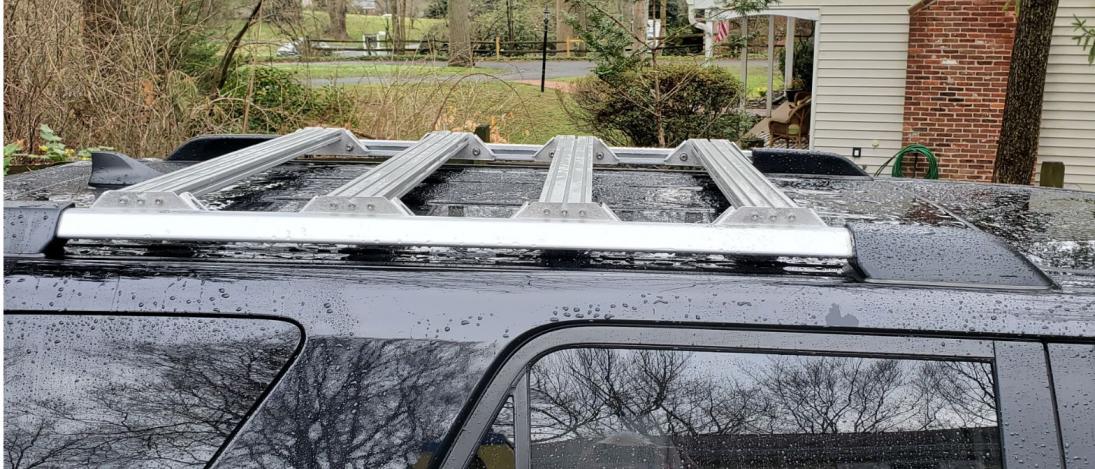

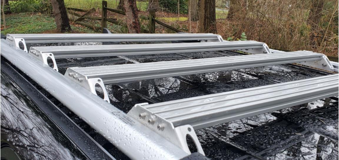

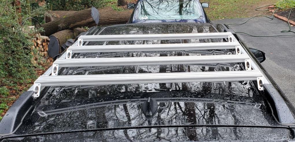

Installed my Niserack today
Easy to install and well built...

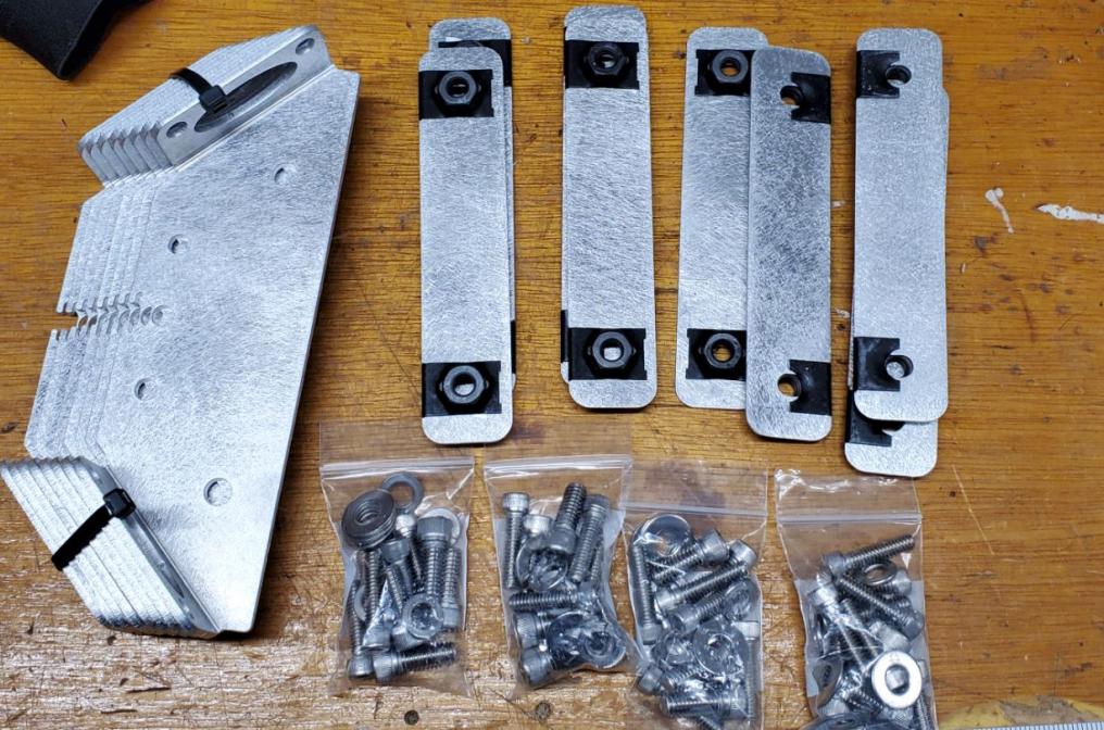

I've received my rack and the components look great! The weather hasn't cooperated so I haven't had a chance to install it yet but hopefully soon...
Any thoughts on a good basket to mount on here? I'm starting to think about ways to mount a couple of fuel cans up there and would like to come up with a way to add sides or something.
Got the brackets on order.

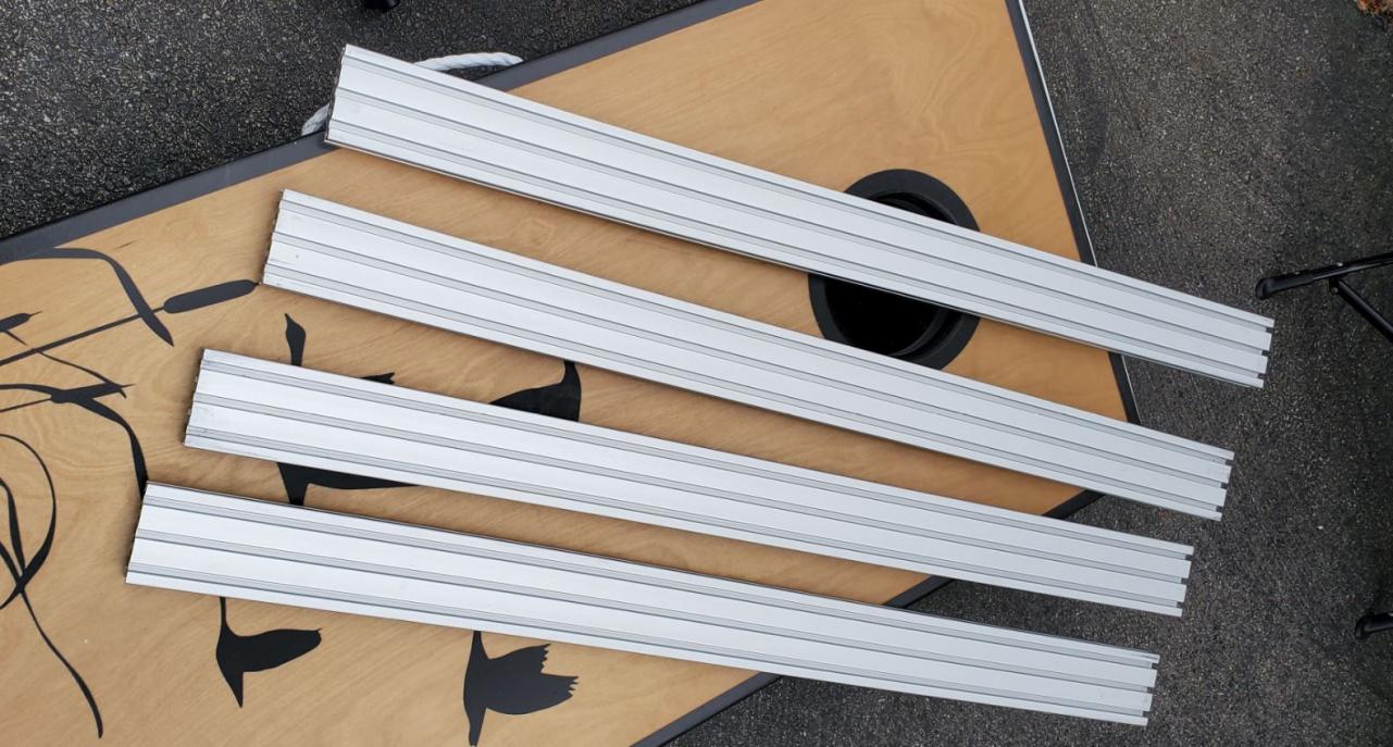

What is the correct crossbar p/n and length to order from tnutz ?
on the FAQ this is listed as:
EX-1030 – 1″ X 3″ SMOOTH T-SLOTTED ALUMINUM EXTRUSION
Inches - 40
Fractional Inches - 3/16
Does that mean 40" 3/16 total length ?
Inches - 40
Correct. When you fill out your order you will fill it out that way. They ask for the inches and then the fractional inches.

Lessons learned from installing the brackets:
1 - remove the REAR rail covers, not the front ! I did not pay attention to the video and started with the one in front - and there is a stop that blocks the rails.
2 - pry the edges of the covers towards you, NOT up !
3 - the front rail cover is $50.- plus tax at the dealer ...
:lol::lol:

Just placed an order for the 3 crossbar hardware set this morning and anxiously awaiting the release of the fairing.
One question I had, if I decide to upgrade later to 4 crossbars , can I order a single hardware set, that option ( single set ) is not currently up on the web site ?
I don't list a single bar for obvious reasons. If you need one I think we can work something out.
