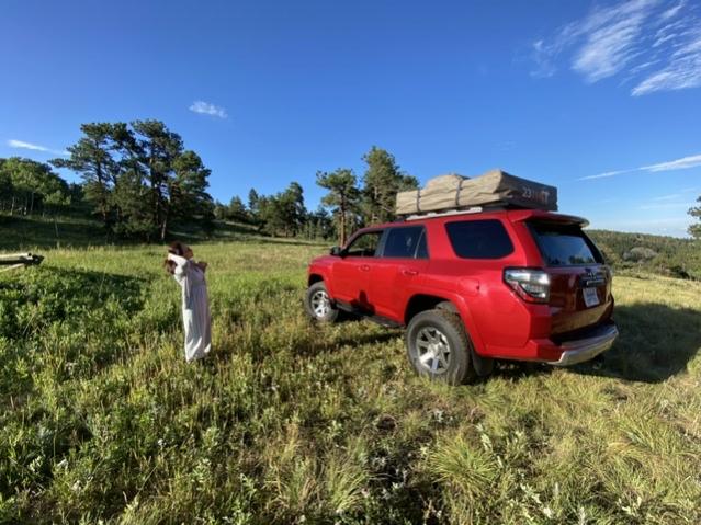

Here’s a pic, it’s from page 4 of this thread.
366466d1595866216-5th-gen-aluminum-roof-rack-using-oem-siderails-niserack-ba939049-fee0-415a-9eff-e5de3efe3c99-jpg
I went out and measured my wife’s NiseRack (LOL). You could easily get away with a roof top tent that is 65 inches in length. That would give you 13 inches of overhang on the outside of each of the outer crossbars. You can still raise your tailgate with this setup and clear your shark fin. I looked at the alu-cab tent and it’s 90 inches which might be stretching it.

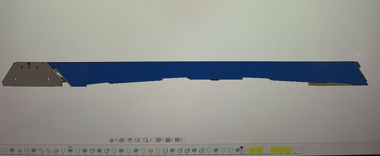

I want to to let everyone know I’m still working at this. Several folks have asked about a faring in the past. I prototyped one up and it didn’t fit as expected. I redesigned it and I’m going to have it built for testing. Here’s a pic of what I’ve been working on. Sorry for the delay but measuring this stuff out and modeling it up takes a little while. It’s one of those measure 3 times and model and then go back and measure twice more. This is literally the first time in months I’ve had several hours all at once that wasn’t committed to something else.
Hopefully I will have the 2nd prototype done after the first of the year and be ready for production. Merry Christmas to everyone!
