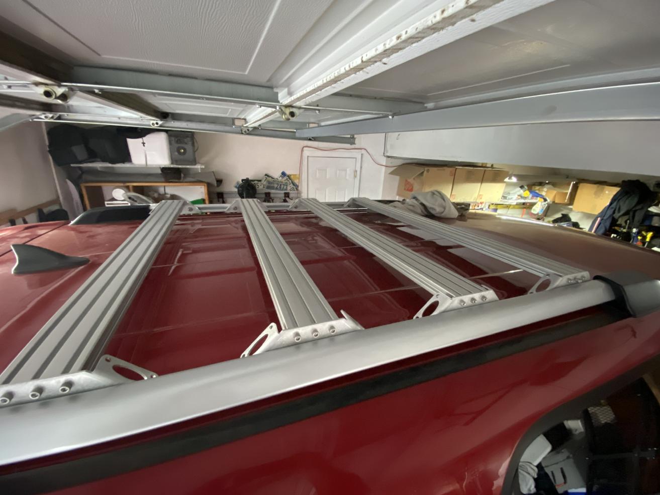

The rack is on! All I can say is, it is awesome. Fitment and design are right on. Rooftop tent will be going on next, and I am sure it will hold. This thing is solid. Only issue I had was one of the holes on the beam from TNutz was not drilled far enough in. Just need a shorter bolt for that one.

For that short hole in the crossbar, maybe it’s plugged with some aluminum shavings from the TNutz drill/tap process. One of mine came that way also, but I was able to clean it out with a thin probe. You could try cleaning up the threads with a 1/4 - 20 Tap. If the hole is actually not drilled deep enough you would need to first drill it deeper before tapping it. I believe the drill bit to use is a 13/64 inch. [MENTION=176262]Eitek1[/MENTION] will know for sure what to do.

Sorry about the short threaded hole on the crossbar. The threads are a 1/4-20 pitch. The holes already exist in the crossbars Tnutz just threads them. Chances are they didn’t run the tap deep enough.
If you pick up a 1/4-20 tap and some WD-40 you can run the tap in and you won’t even have to remove it from the roof. You’re also fine with a shorter bolt. You probably don’t lose much strength.

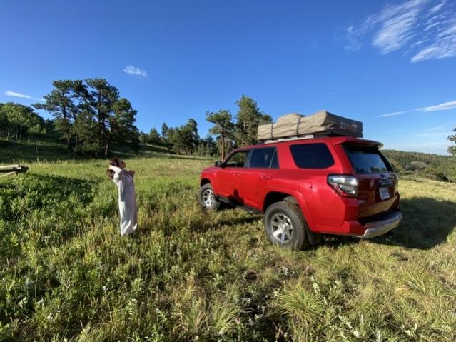

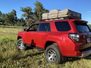

Tent on. Fits perfectly. Tent rails sit about 3 inches from the sides, so zero flex on the crossbeams.
