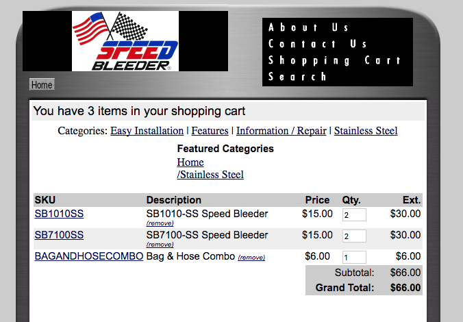

Here was my first (Brass) speed bleeder order from the speed bleeder website:
SB1010 Speed Bleeder Sku: SB1010 qty: 2 x $7.00 = $14.00
Bag & Hose Combo Sku: BAGANDHOSECOMBO qty: 1 x $6.00 = $6.00
SB7100 Speed Bleeder Sku: SB7100 qty: 2 x $7.00 = $14.00
Extra Dust Cap Sku: DUSTCAP qty: 1 x $.10 = $.10
After I broke off two of the brass ones by over tightening them, I gave up and ordered all stainless steel ones. In some of the reading that I did, I saw that racers (for example) prefer the stainless steel, because they often flush their brake fluid after every race. I decided to go with the Stainless steel for durability and piece of mind. If I (or a mechanic) flush my brake fluid a few years from now, I don't want to have a speed bleeder that is so fragile that you will over-tighten it and shear it off if you aren't careful. I'd rather have something stronger... for piece of mind, and for fewer hassles down the road.
Here's the Stainless steel order from speedbleeder.com
So for $66 instead of $34, I feel the stainless steel is worth it.
Just my $0.02.
