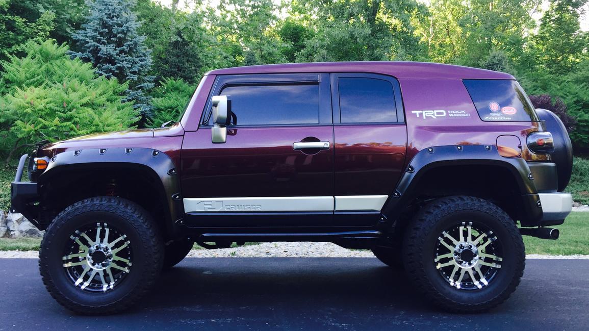

ok great thanks,looks like the Centric is the only Caliper out there on the 5th gen ... were doing the upgrade on our FJs in the FJ Cruiser forum via weight bigger tires wheels etc . and its working out great
