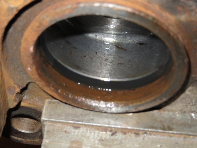

After reading a ton of posts about stuck pistons not only in our trucks but also other vehicles and analyzing my calipers and their stuck pistons, it appears the issue starts with corrosion from the outside making it's way inside. At least this is the only thing that I found to be the issue and after cleaning out the grease and rust, the pistons did not become stuck again until a year after.
I've noticed that on every piston that seized/froze, there was always rust making it's way under the piston boots (through the metal) and inside between the pistons and caliper's piston cylinder. It doesn't take much for a piston to seize/freeze especially with such tight tolerances AND heat. Heat will cause parts to expand and change tolerances.

P.S., Iron calipers tend to experience these issues more, iron rusts fairly quickly and reacts more to water and salt especially. My other vehicle has aluminum factory calipers and to this day from 2012, I have never touched them. So that should shed some light as to what Toyota should've done in the 5th gen essentially but what can I say.
Below is a photo showing how rust creeps up inside the piston cylinder. Thank you to the kind member that posted this in another post.
