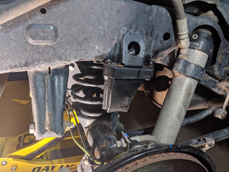

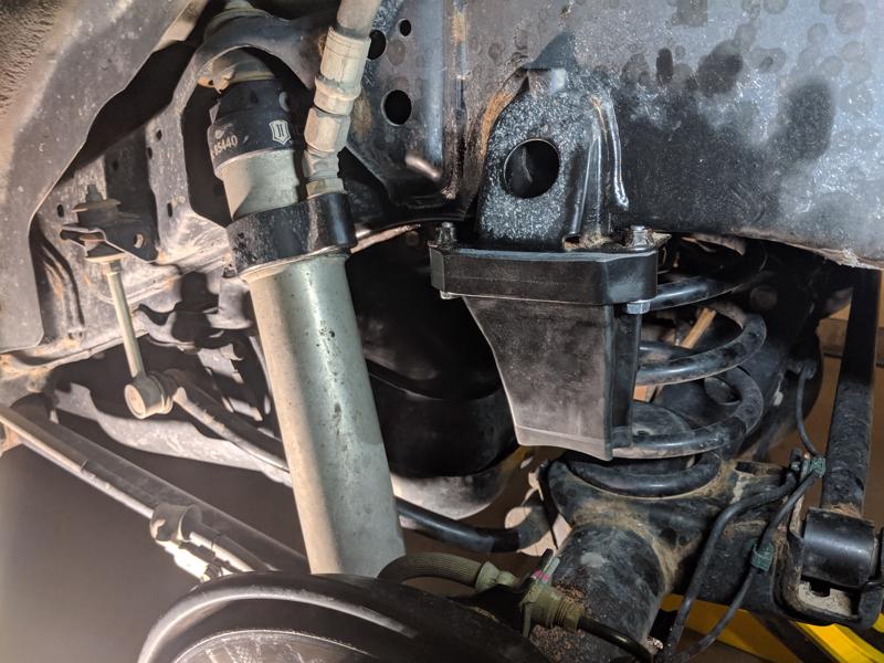

I installed my rear bumpstops today. They were not “symetrical” as stated in an earlier post and did have a “groove” for one of the mounting holes. The durobump website install instructions says the groove should face inward. I intially mounted that way but this put a good bit of the bumpstop hanging outside the mounting flange and it appeared it would land on the abs sensor wire when it contacted the axle in a bottom-out situation. So I ended up swapping sides of the vehicle with them. It looks like this affords more solid mounting and no interference with any wiring when bottoming out. The groove area is facing out....or towards the inside of the tire.

That's how mine are installed as well. I can't remember what the instructions said but I think I did the same thing by accident at first; notch towards the diff. Definitely wasn't right.

I had this same issue as well. I read the instructions and when I lined it up it just didn't make any sense. I messaged him on IG and he said it was a typo. The notch should be on the outside. This is the way it should be installed.
