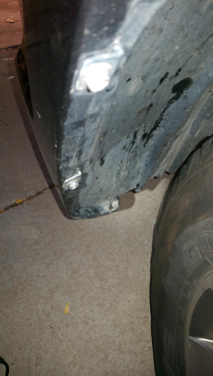

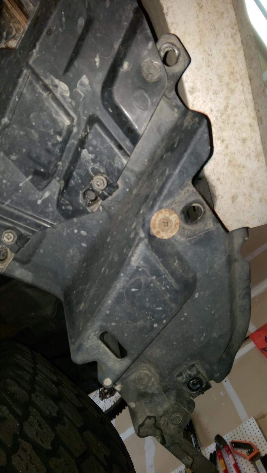

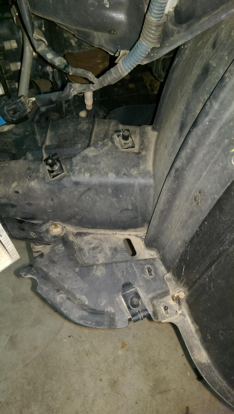

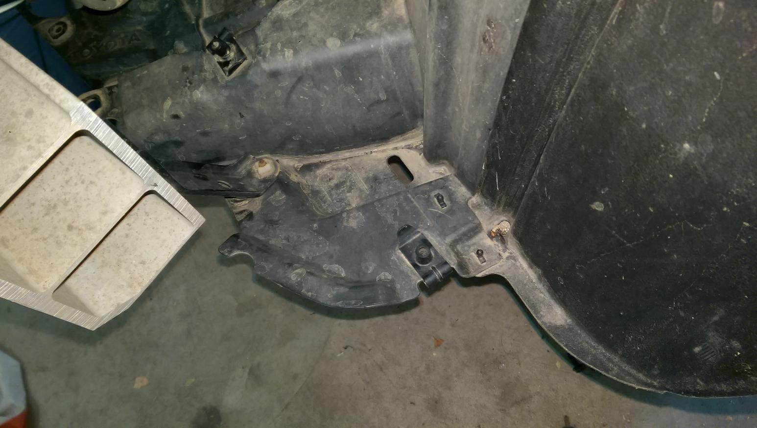

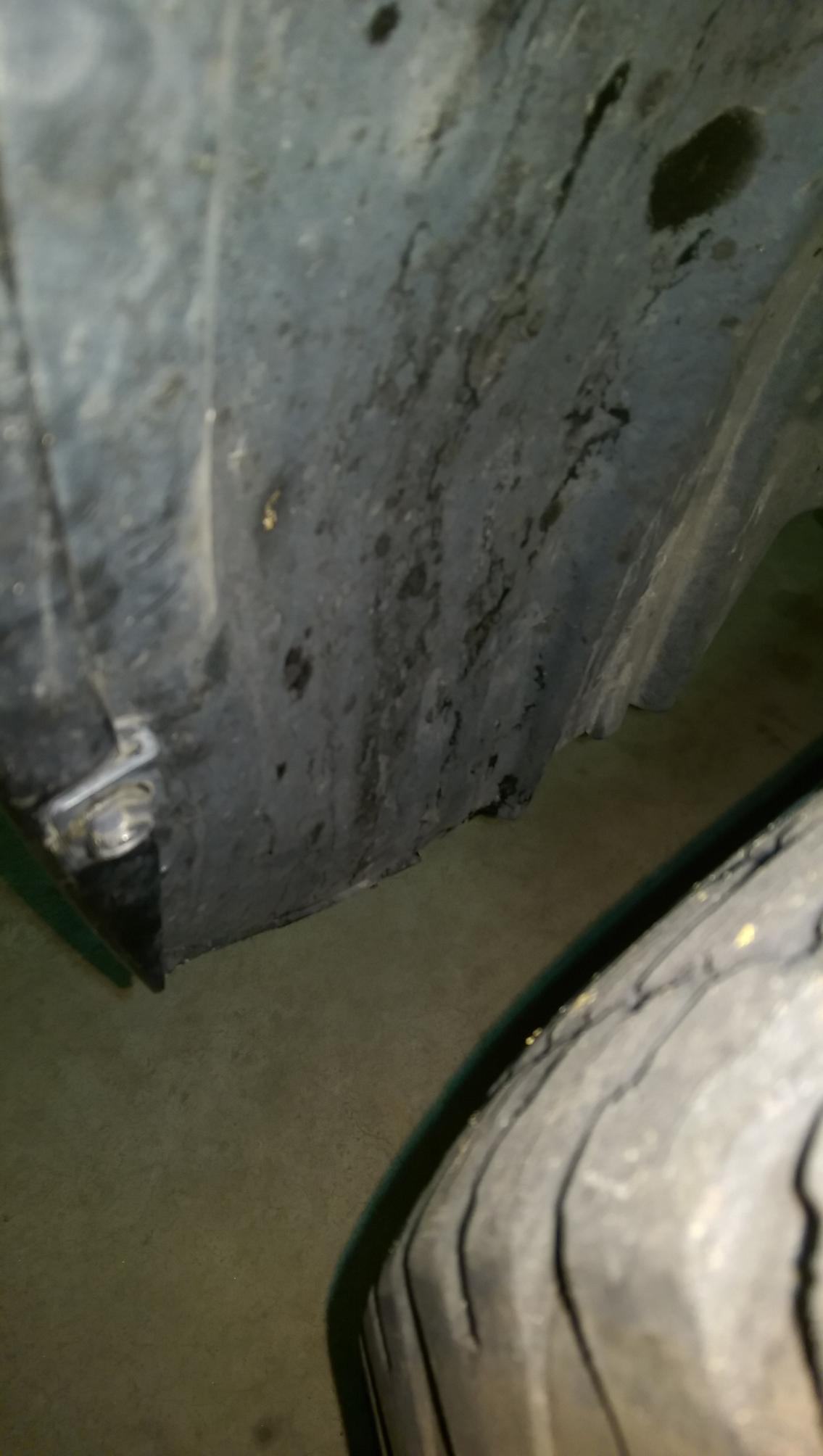

Did this mod for my 2011 SR5 and thought I'd share some pics since it looks a little different than the TE.
I happened to have my bumper off already so you can see the top side.
After pushing the fender forward 3/4" the front 'inner' corner seemed to be pulled in slightly. To counter this I moved the two screws that line up off the corner a bit.
After moving the fender forward you see part of the outer trim hangs over a bit. I cut it off with my dremmel.
All photos are drivers side.
