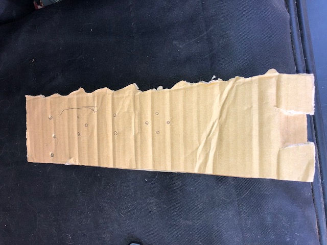

I started by making a template out of cardboard to get the relative size to trim the sheet metal down to as well as align the holes for both mounting the sheet metal to the car (using pre-existing holes) as well as the fire extinguisher bracket to the sheet metal.

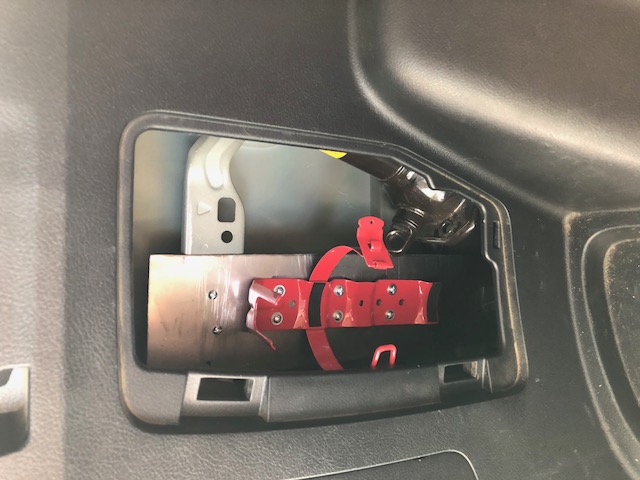

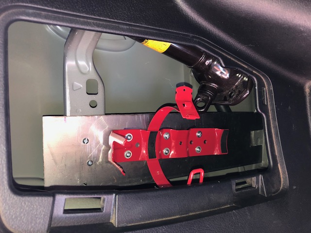

Then trimmed the sheet metal down to size and made sure the holes still aligned. For the bottom section, since it reached all the way to the bottom, I simply cut two notches and bent the middle section making it pressure fit over the metal on the car. It should hold fine since the top is secured and there is no movement in it. I made sure it fit first, then removed it to add the bracket to the sheet metal. Once that was together, I reinstalled the sheet metal back into the car. Word to the wise...be very careful with tools in that space. If you drop one, it my be gone for a while. Thankfully I had an extendable magnet to get the wrench I dropped.

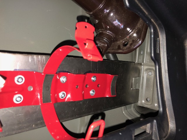

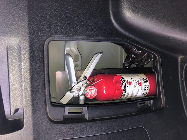

Once everything was secured, it did take a little finagling to get the actual extinguisher in there. The nozzle was directly hitting another section of the frame. Thankfully the bracket was flexible enough to put the nozzle in first, then angle the extinguisher on the mount. Once I got it in and secured, I removed and replaced a handful of times. It was 10x easier after the first time and extremely quick to get out if needed.

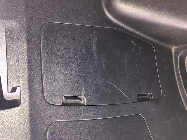

Once it was all mounted, the cover fit perfectly back on. Super happy with how it turned out! Hope this helps anyone still looking for a solution!
What a great mod and not being able to see it makes it even better
Didn’t time it or anything but I would say it’s almost as simple as just having it laying back there. Pulling that plastic cover off is nothing. Flipping the latch and grabbing the whole top/handle and pulling it comes out with ease.
Agree if timing is the primary concern, having it in the back altogether isn’t the best idea since you’ll spend most the time jumping out and running around the car.
All the tools besides the jack are laying flat under the sliding tray. Could be a pain if I need them and stuffs stacked back there, but hey, the tray slides right?? ��
