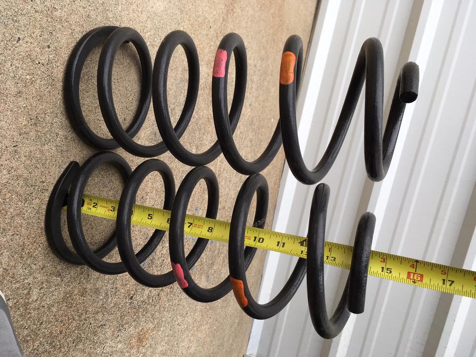

Just in case someone wants the length, these are from my 2017 SR-5 P 4x4
