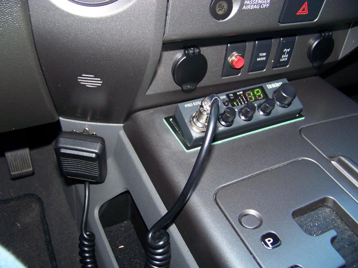

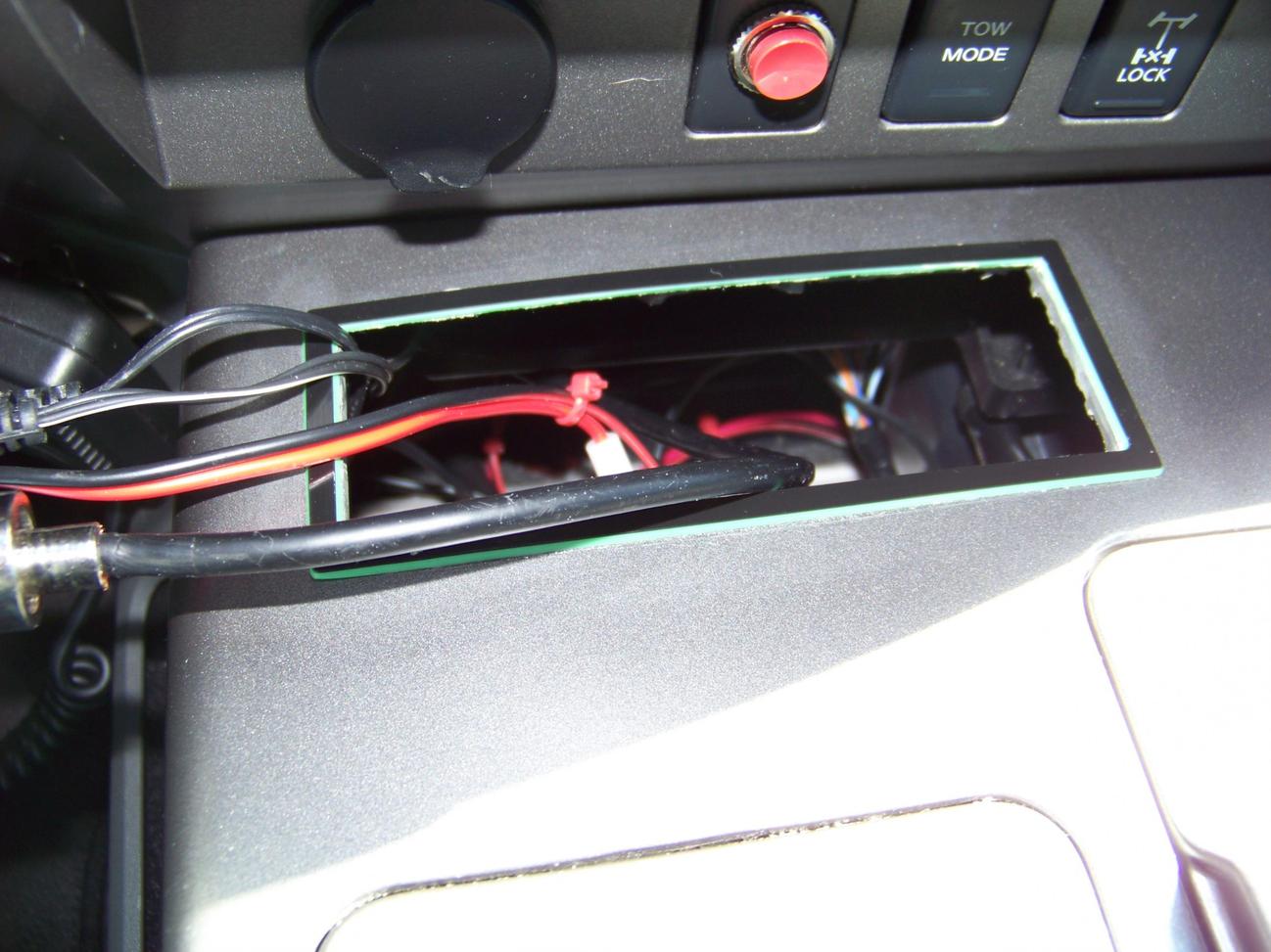

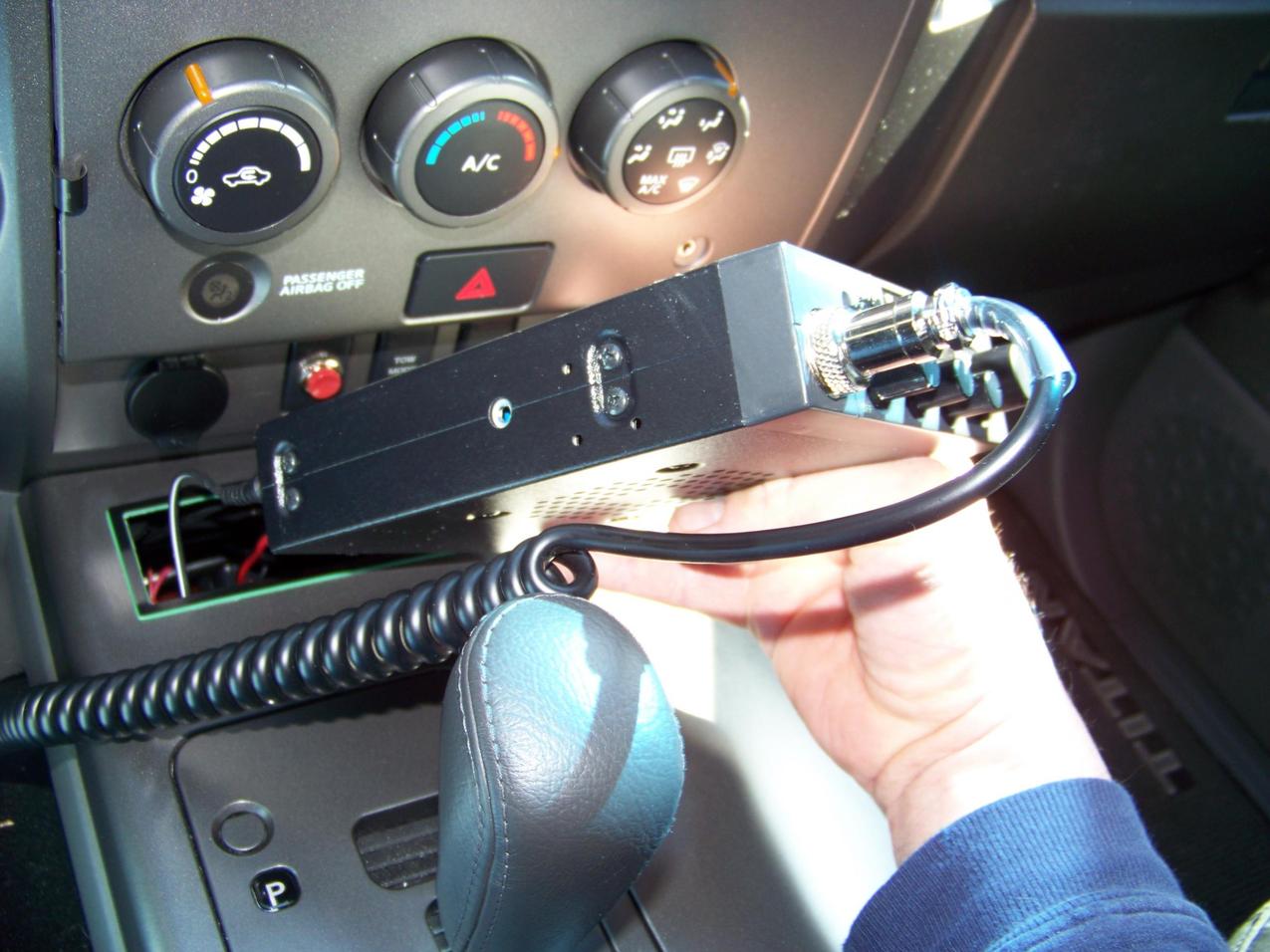

This is what I did in my Titan about 5 years ago. It's a smaller CB though- Uniden 520XL.
I'm not sure you will have enough room to mount yours like that in the center console, but I am sure it would take a lot of cutting! Maybe this will spark some ideas...Good Luck!
