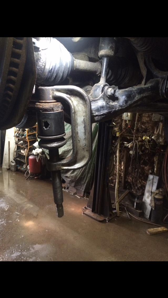

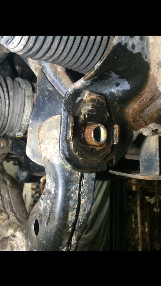

Couldn't find anything on a 5th gen so i did a half azz write up, started by taking off lower joint holder.

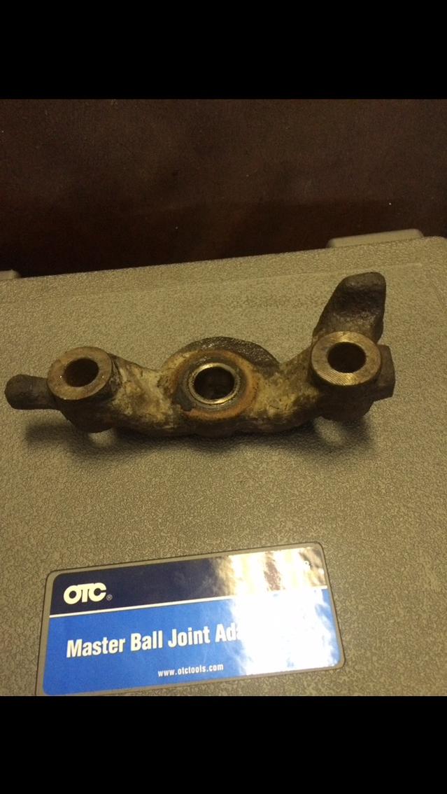

otc press installed but could not move it . Runner lives in most corrosive enviroment on earth parked 100 feet from ocean so salt air is always present and copous amounts of road salt all winter

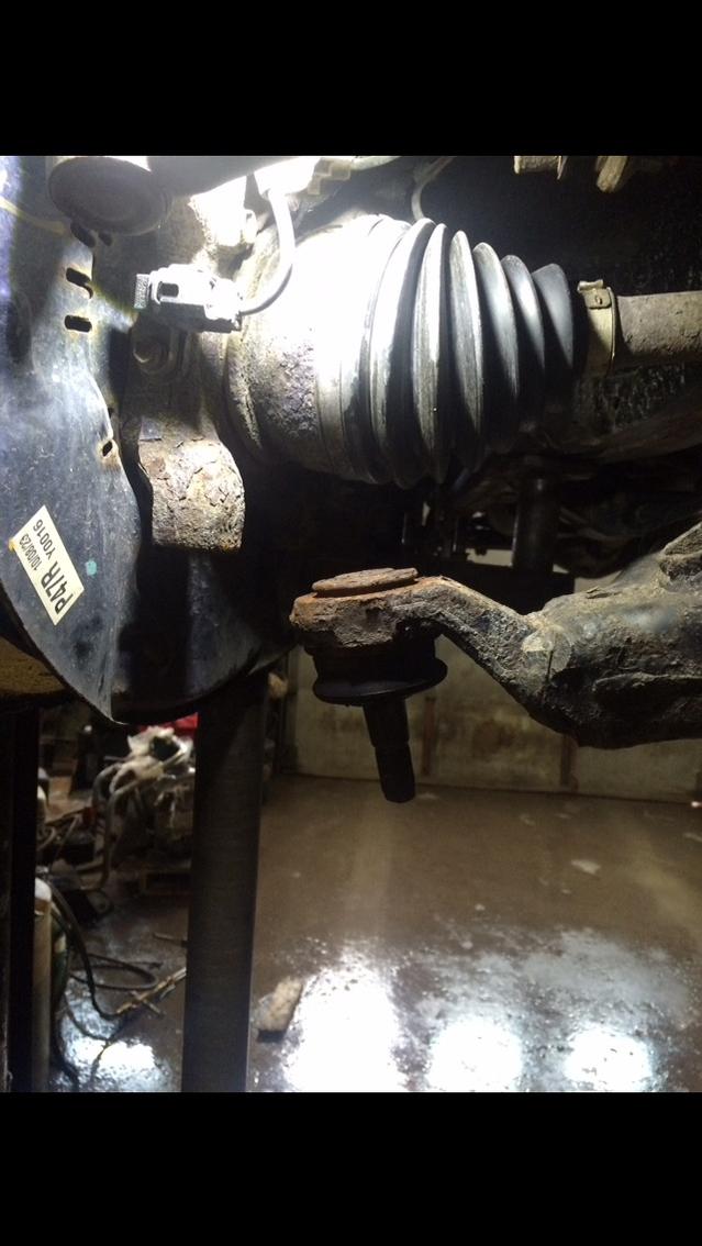

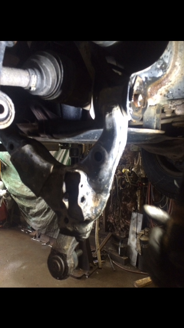

decided to remove a arm and use hyd press but couldnt get a arm out due to the sleve being frozen in bushing and didnt want to mess it up as new arms were 3 days away at a cost of $500 each

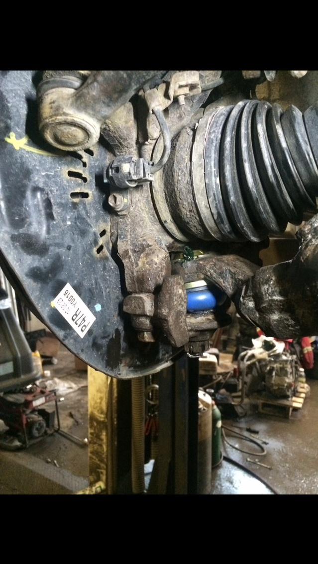

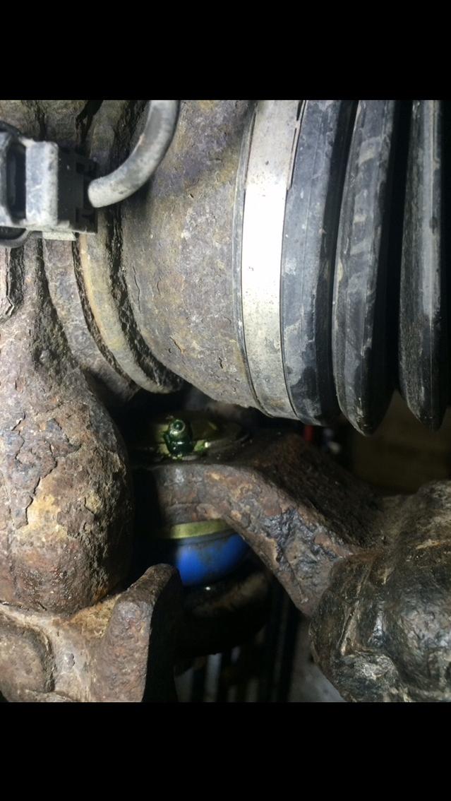

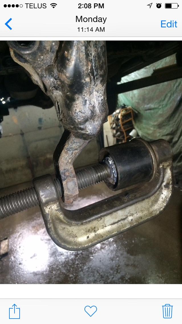

so with a little heat 3/4 drive power handle and snipe and some good wacks on c clamp from this position it gave way finally , it needed the hammer blows to come free and this position is the only way to get a good swing at c clamp, it just laughed at the 1/2 air impact gun on c clamp

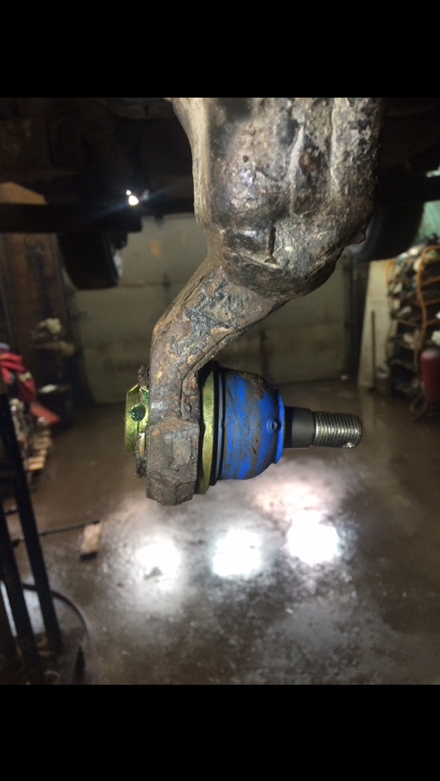

in with the new , splicer life time warrenty , the inpact even had a hard time pressin this one in and as i read some where before with moogs the snap ring slot doent come out enough to get ring on , this was also the case with these the barrell is just a thou too short so we ground a little off the snap ring to get it in the groove , and yes it was pressed in as far as it will go trust me , also remember to orientate grease nipple in correct location before pressing in .

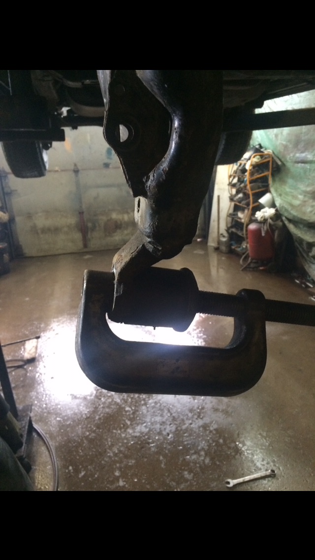

shes in and arm back together , remember to only torque a arm bolts when full vehicle weight is on them if you loosin bolts for any reason ,and of course i marked the cams before dropping the a arm , i was due for an alligment anyways so took er in to get it done and they didnt even have to adjust it again , got the otherside without droping arm just a little longer snipe , bigger hammer and it might not of been rusted as bad but still took alot of force to get it to start moving.
that concludes this write up only 90k km on this never off road , if it was rust free its a nice eazy job , hour per side i would say total start to finish . Add rust and that goes right out the window .Torqued everything to spec , also installed new sway bar end links while i was there , lifetime warrenty ones , org ones were sloppy and had play
