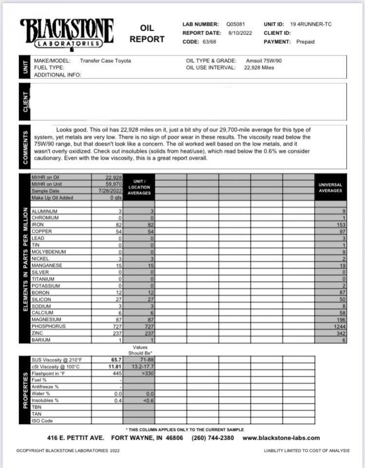

Brass/Copper synchronizers in our transfer cases? Video is of a transfer case out of a 2017 Taco, complete disassembly; halfway through the video you will see the brass/copper synchronizers. Looked up replacement fluids and reached out to Redline and Amsoil, Redline has a GL-4 75W replacement fluid but Amsoil has no substitute. Redline web site states the GL-4 lacks the Sulphur that damages the brass/copper components that the GL-5 fluids have.
The question is should we be using a GL-5 75W90 in the transfer case?
https://www.youtube.com/watch?v=DlOm8_Tt81c&feature=youtu.be
Here is the UOA of my transfer case running Amsoil 75w90 GL-5, according to Blackstone it looks good.
One thing to consider is Blackstone doesn't test for Brass; Brass is an Alloy (Man Made Metal) comprised of Copper and Zinc. Zinc being a EP additive added to engine oils it would be hard to make a determination of synchronizer damage. However, Copper is low/average according to Blackstone so that is a good sign.
In all fairness this was a short run of 22k miles, not sure what long term usage of a GL-5 fluid in the TC would look like.

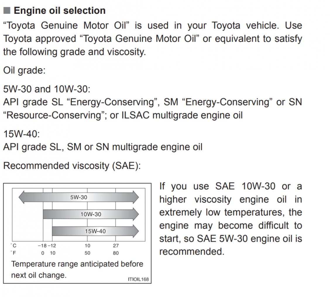

For those running 10W30 engine oil, had anyone done so in cold months? Wondering how it does in single digit temps.
I've run 10w30 a few times now but I live in florida, I would Not run a 10w30 in a cold climate. Last winter we had frost 2 times in my part of florida and the 10w30 made the engine harder to turn over. It actually made the timing chains make a strange noise like they slapped the timing cover slightly. Whatever it was I will not run 10w30 in colder climates, even down here in florida.
5W-30 would be a better choice according to this page from an FJ Cruiser owner's manual for the UAE-EURO market.
