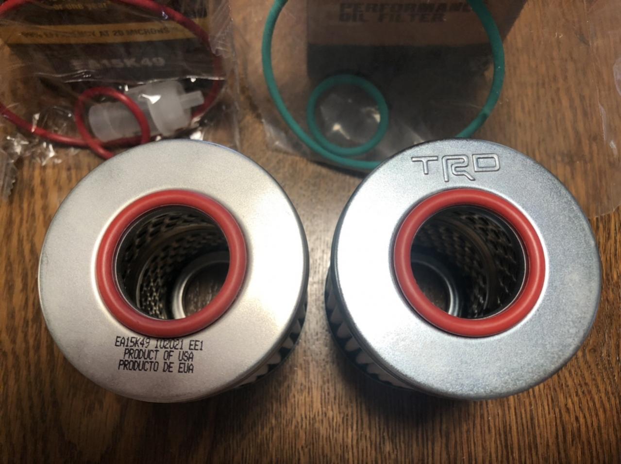

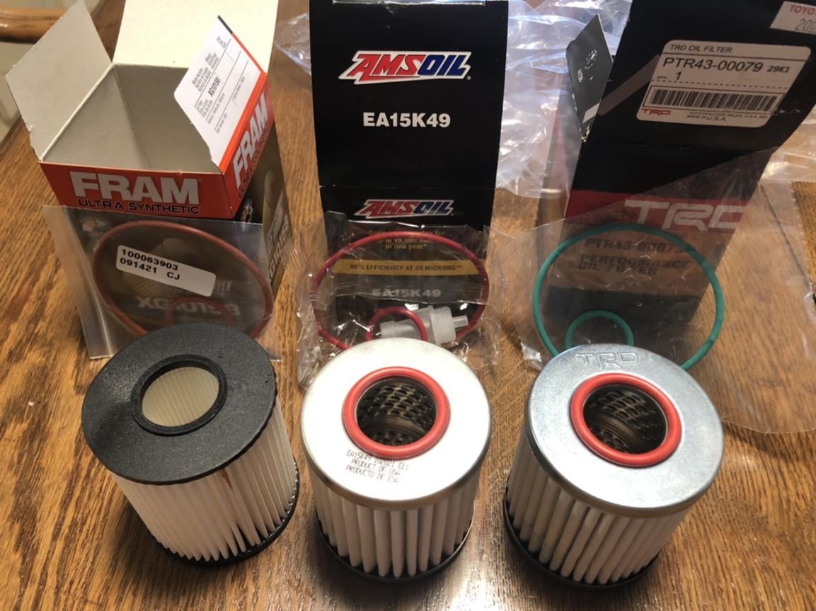

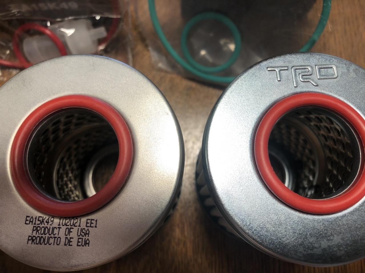

Fram - Amsoil - TRD oil filters seem to be a good synthetic option. The Amsoil and TRD are built heavy duty, Amsoil being rated at 15k miles but no mileage claim on the TRD, but both look to be made at the same factory. Only difference is the end caps and different color gaskets. Fram claims 20k miles but that seems silly to me.
Looking forward to not having to drop the skids for an oil change for 15k miles :)

Fram is a horrible filter. Last filter I would ever use or recommend to anyone.
Royal purple “makes” a filter exactly like the TRD and amsoil filter. All three are probably made by the same company. It’s also the cheapest of the 3 for 12 dollars compared to 20 for the others.
Royal Purple 20-968 Oil Filter
How is this metal framed filter (TRD etc) any better than the standard OEM filter? The paper element does the filtration and I bet it’s the same thing in both.
I didn't realize that royal purple made an oil filter for our rigs, looks to be another great option if your in the market for a synthetic oil filter. Thanks for sharing.

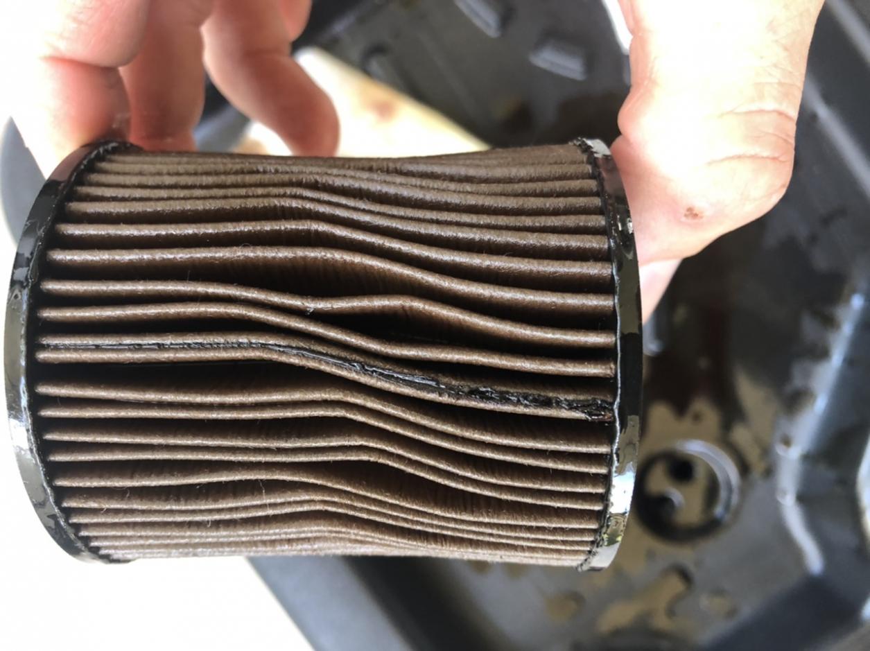

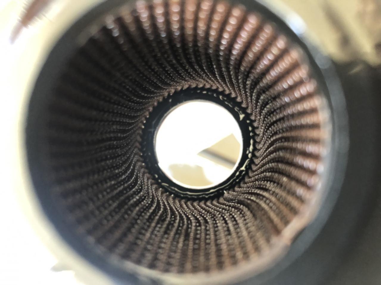

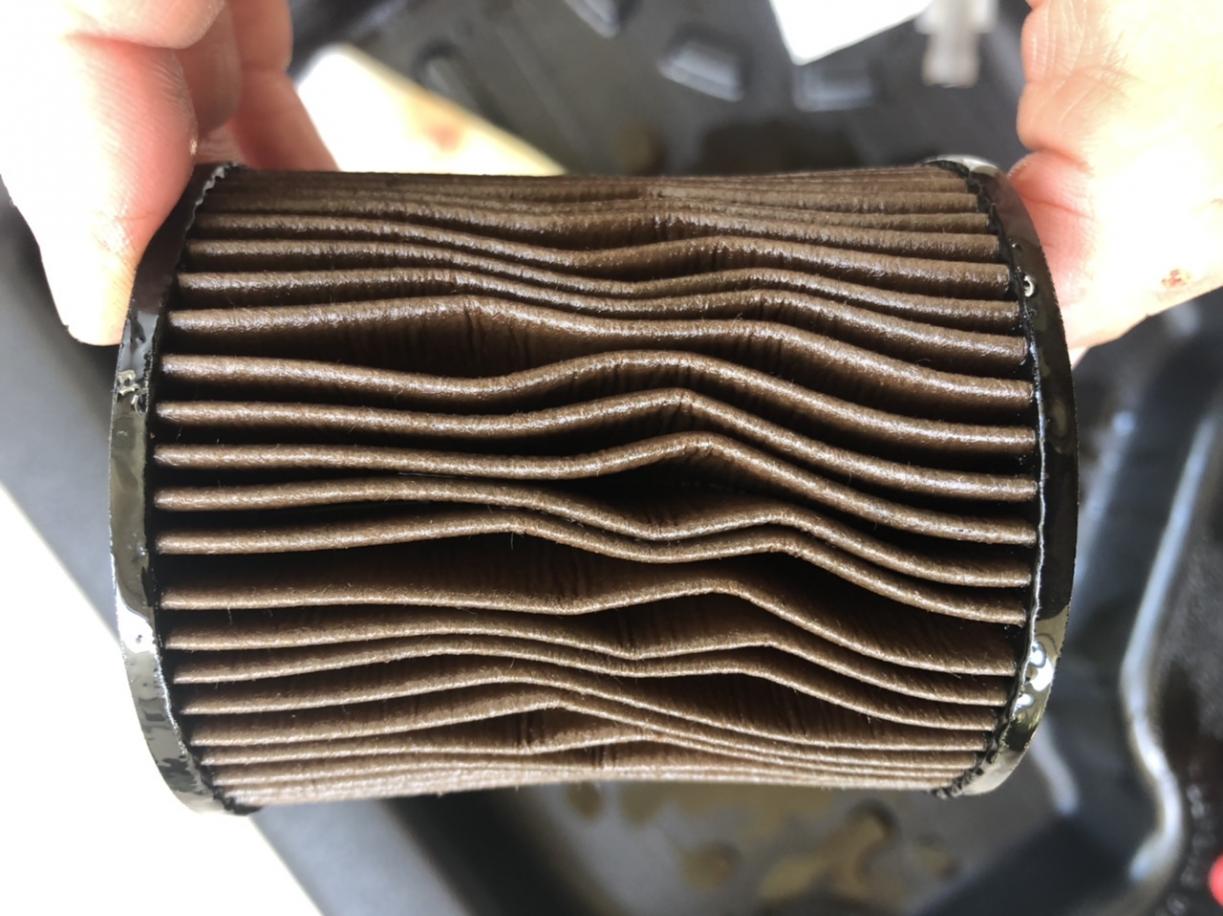

Well the results are in, looks like the Fram took a beating from the 10w30. 7000k+ miles, the last 1100 miles I pulled a loaded trailer from Michigan to Florida, locked in s4 she was huffing and puffing. The fram box shows a wire backing but it’s just marketing, no re-enforced wire backing. Did it Fail? I would have to say yes, however, it didn’t come apart. But it did lose its structural integrity.

Fram has a technical information bulletin on collapsed oil filters https://www.fram.com/media/1084/collapsedcentertubes.pdf I'm also wondering if one of the end o-rings from an Amsoil or TRD filter came off, remained stuck and caused the Fram filter to buckle during installation. After several Google searches and looking at photos of deformed oil filter cartridges, I think this Fram filter is twisted, not collapsed. The first image appears to show twist. Do you have a micrometer to measure this Fram filter height and compare it with a new OEM filter? As I recall, the center metal tube is spring loaded, so it should accommodate small variations in cartridge height. Do you have the metal oil filter cap? If so, did you install the longer center tube and is it free to move slightly? I have doubts about oil weight causing this. I suggest sending the photos to Fram and asking them what happened. https://fram.pissedconsumer.com/customer-service.html

Fram is garbage, has been for many years.

Your pics simply show that the length of the filter was compressed when mounted. There really is no failure of the media as you show it.
In reality it is a common occurrence with this type of filter assembly, especially for example, with the GM EcoTech engine family, where literally gazillions were made, and yet the engine has the least amount of warranty claims of any GM engine ever.
The problem is caused by a filter cartridge that may be a hair too long combined with less stellar (rigid) filter material. When installed the spring loaded relief valve is too strong for the media and slightly twists and distorts the media. You can measure the cartridge with Vernier Calipers.
The spring loaded metal tube assembly reference previously is the filter bypass, not to be confused with the oil pressure pump bypass. When the filter media becomes full and cannot process oil, it moves to allow the oil to bypass the filter completely.
The GM EcoTech filter relief assembly has a spring that is easily 2 or 3 times stronger than ours, hence why it is much more common.

No I didn't take any measurements of the oil filter and I'm still running the plastic housing. I guess looking at it as the "glass half full" I'm glad it didn't come apart. My main disappointment is the Fram box showed a wire backing to support the filter media but its just a marketing scam.

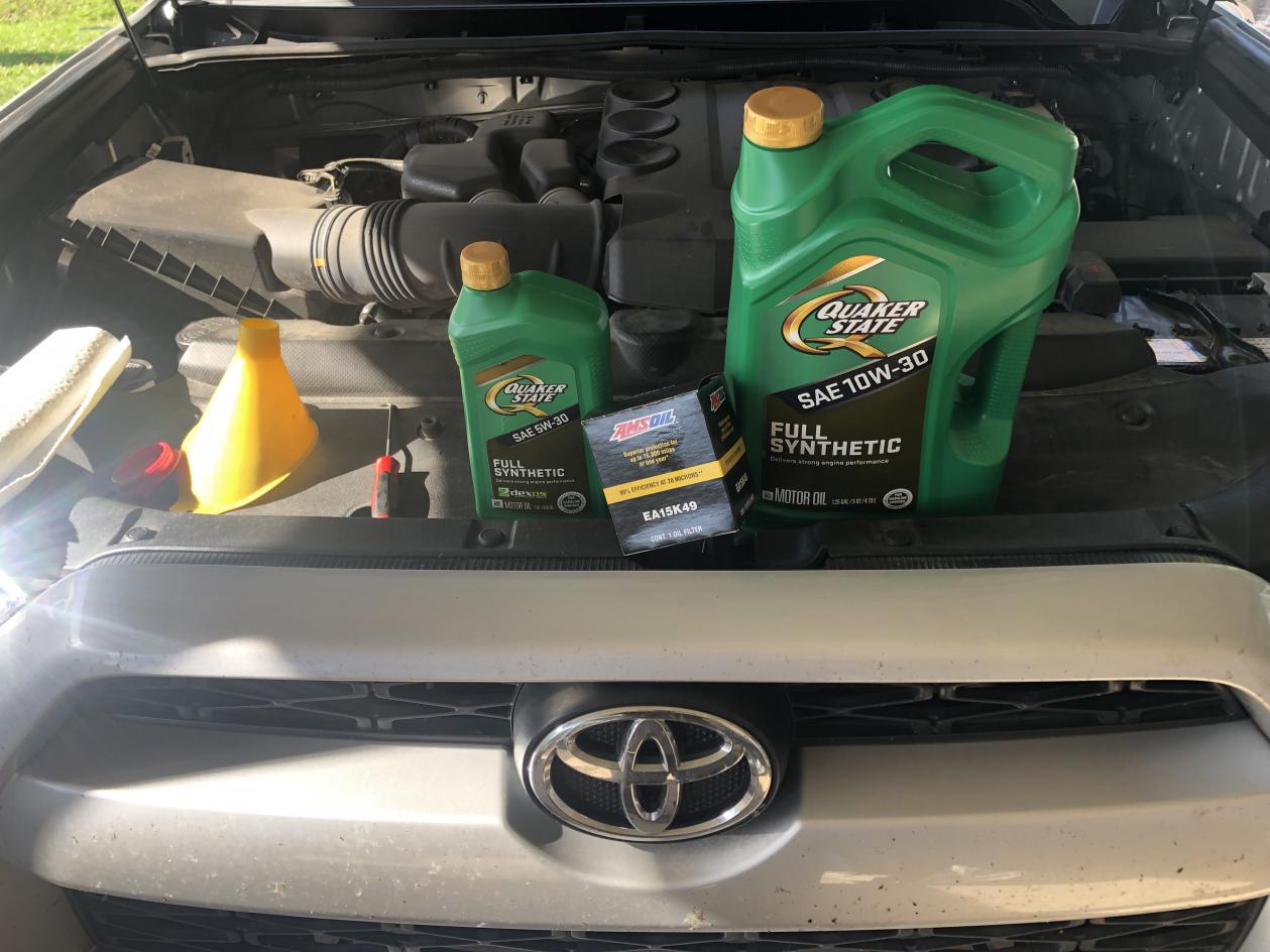

Yes Sir, that 5w30 in summer is "Butter Smooth"! I'm currently running a 10w30 and the engine sounds and feels really good.
