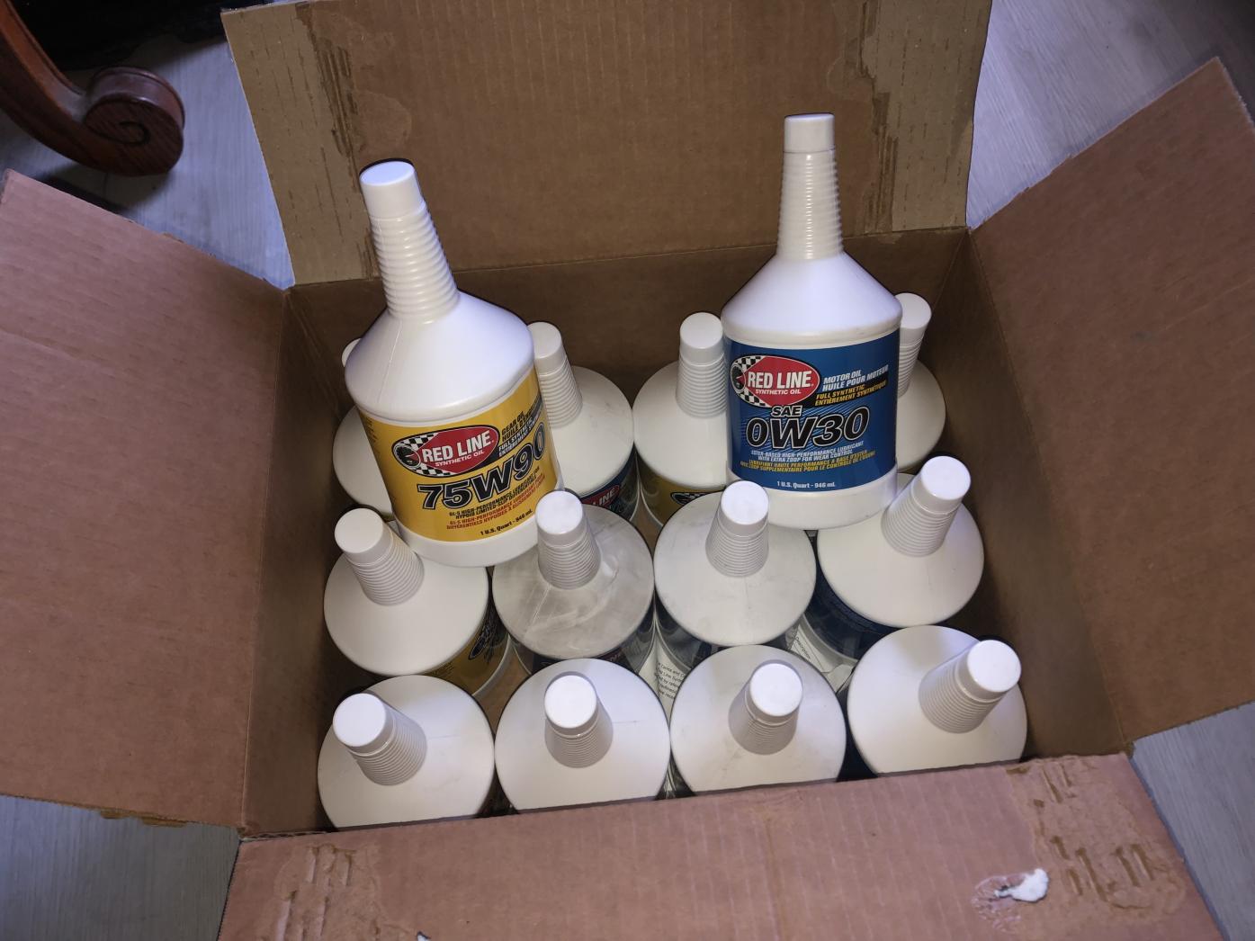

My 4R rolled over the 60k mark last week, she's getting a fluid overhaul this weekend. Giving Redline a try for the first time; I've heard good things about Redline over the years. Any Redline users on this thread?
I put Redline MT-LV GL-4 in the T/C four months ago, no issues.
I've been using Redline for decades in trucks, cars, motorcycles, racing engines, etc. Never had an issue due to the lubricant...
My philosophy is if something lasts 200k miles with OEM lubricant changes, I’ll keep using OEM. But since you already tested this one out, i believe I can make an exception [emoji23]
i currently have Redline 75W90 in the rear axle of the 4R and their MTL in the manual trans in my Honda. it made a marked improvement in shift quality in the Honda trans so i felt compelled to give it a shot with the Toyota.
