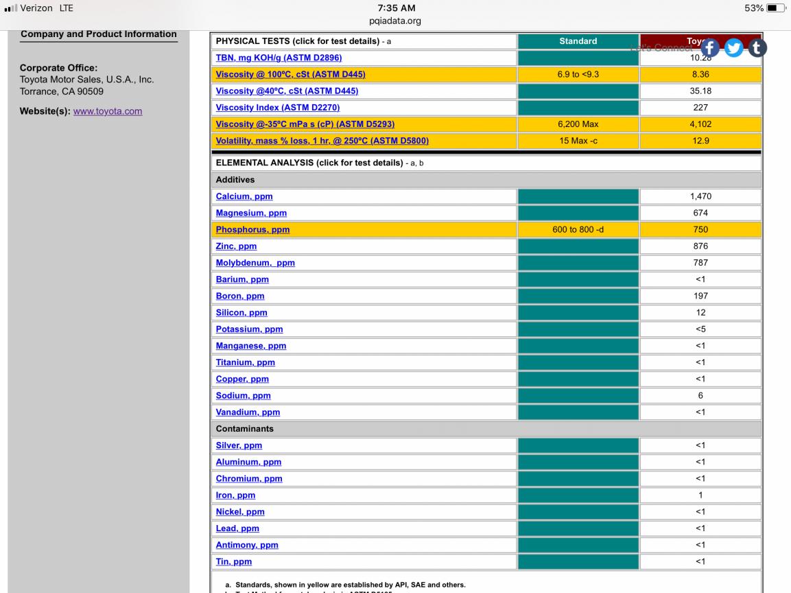

Here is a snap shot of the Toyota 0w20 tested last year 1-24-2018 for reference. The additive package is Loaded and is far superior than any off the shelve oil available at the parts store. There are some good off the shelf oil that will work perfectly fine; Quaker State Ultimate Durability (QSUD) is one ive seen some testing on and it performed very good, respectable Moly numbers also. That Amsoil Signature Series info posted above on PQIA is the older formula, they changed it not to long ago to meet the new SN PLUS requirements. They dropped the Calcium ppm and added Magnesium ppm. The new formula tested Very high on the Rat 540 oil testing site, along with the Toyota 0w20. Amsoil Signature Series and Toyota both get my vote, both are awesome.

I didn't mention Moly? Really? Only about 5-6 times lol. DO yourself and everyone else a favor and READ through this thread. If our engines didn't benefit from the Moly and Zinc, Toyota wouldn't have formulated their oil with such incredibly high levels of both. Again, this is why the 4.0 runs so much quieter when using Toyota spec oil.
