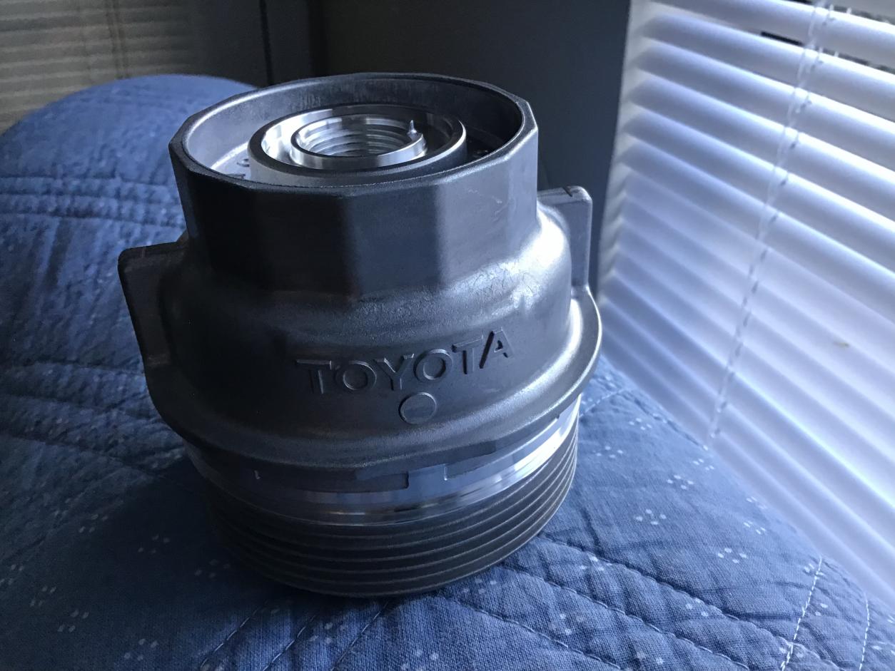

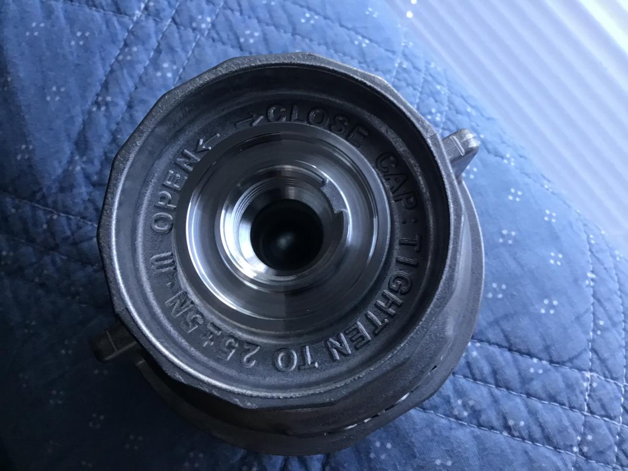

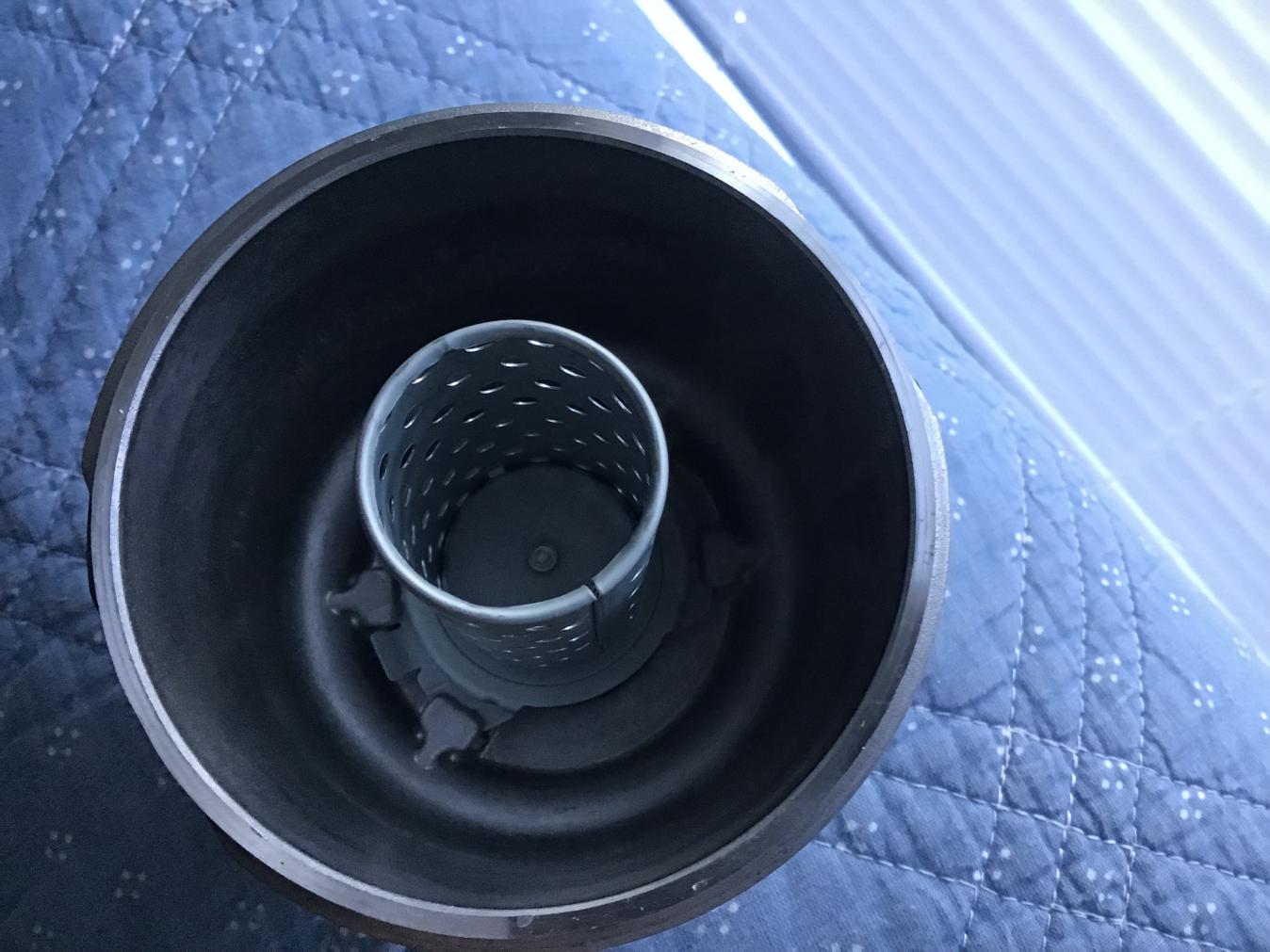

Got home from work and Amazon had a nice little package waiting for me, got my OEM aluminum oil filter housing in and it looks to be a very good part. I think this is a nice addition. Can anyone tell me about the center tube? Is the one on the aluminum housing the same as the one in our plastic housing?
You'll have to swap the center tube over from your OEM plastic one. They pop right out, no effort at all. I ordered one for my 2019 Highlander since I am getting close to 2K miles so the first oil change will be done in the next couple weeks. Curious to see what center tube is used on that housing.
Thanks man I appreciate the information, I can’t wait to do my first oil change just rolled over 1000 miles LOL.. The center tube looks to be good quality on the aluminum housing but I have nothing to compare it to. It looks to be made of aluminum.
Your OEM tube in the plastic housing looks identical but maybe an inch longer? I don't honestly remember, it's been 2.5 years since I swapped mine over.
