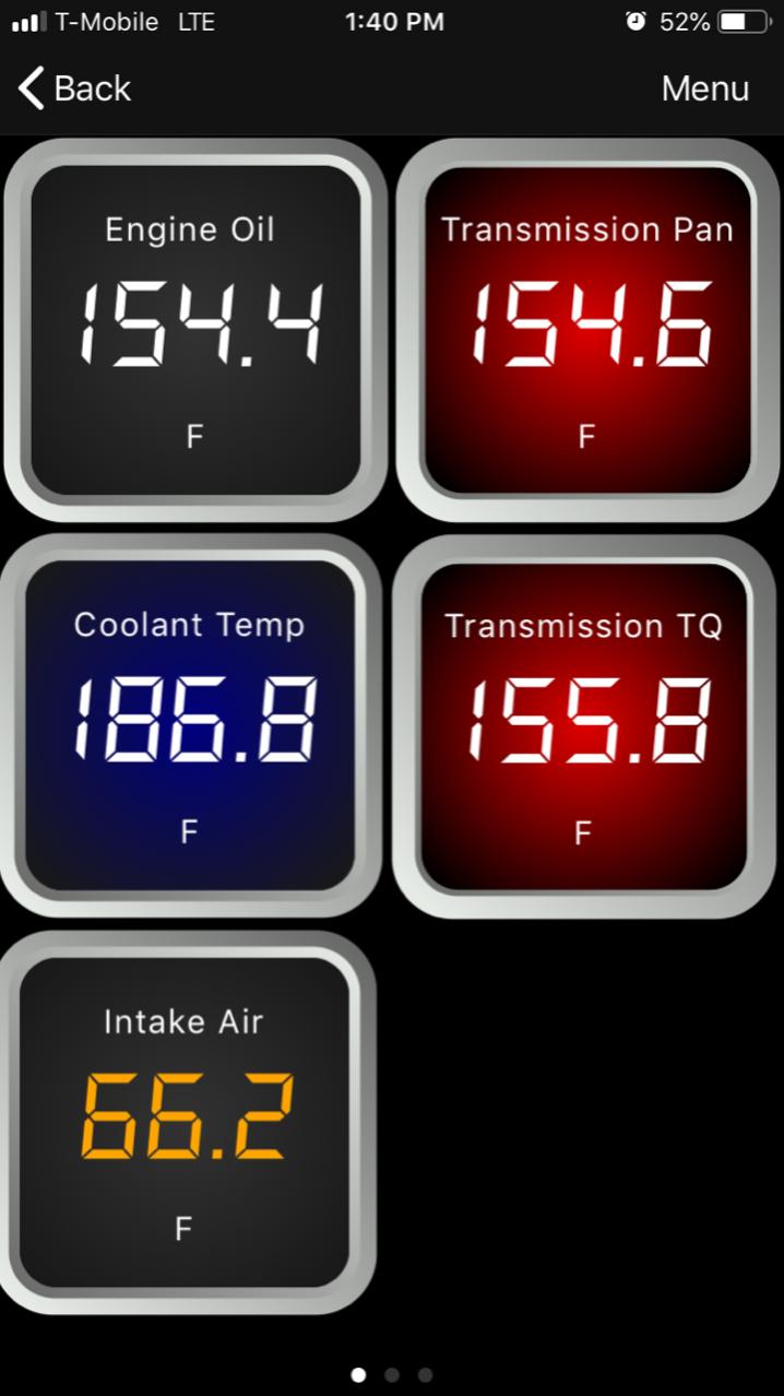

If your running a thicker oil pay attention; see pic!
I’m using a ODB sacaner/monitor that uses Bluetooth to communicate with my phone, got it set to monitor my fluids and a few others.
Engine oil Only got to 154.4 degrees Fahrenheit coming up from Florida to Georgia, running at 70-79MPH for over 8 hour. Most modern vehicles usually run 200+ degrees Fahrenheit. So what does this mean for the 20w oils and the 30w oils? Both will run thicker at operating temperature in the Toyota 4.0!
Most oil manufacturers will give you a cSt value at 104 degrees Fahrenheit and 212 degrees Fahrenheit on the data sheets. This gives you the viscosity range of that particular oil under normal operating temperatures. 212 degrees is a representation of the oil at Operating Temperature; so if your oil is running cooler it’s also running thicker.
Last time I was in Florida it was hot and and my oil temperature got to 173 degrees Fahrenheit, but I didn’t get a picture of it. So the ambient air temperature seems to have an affect on oil temps.
So if your running a thicker oil check the data sheet cSt and understand that your oil is running cooler/thicker.
my understanding is that our engines don't even have an oil temperature sensor, just a simple oil pressure switch for the dummy light. so, any idea where the scan gauge is pulling oil temp readings from?
no modern engine should be running oil that cold on a normal basis. that's waaaay under temperature for proper oil detergents to work right and would not allow for water vapor to burn off on a regular basis which creates other issues.
temps will definitely climb above typical ranges in hot weather but regardless of how cold it is (within reason, not talking like -50 in Alaska), after extended normal operation the oil temps should always reach a consistent ceiling.
this is very strange.
I have never seen an oil temp sensor on a vehicle for the engine.
transmission fluid temp is common.
Toyota does not have an engine oil pressure sensor . as you stated just a switch which is ODD IMO !!! I do have the scan gauge no sensor so no oil temp or pressure data...
I monitor the tranny temp all the time.. engine coolant temp is very stabil .. engine has a good coolant system.

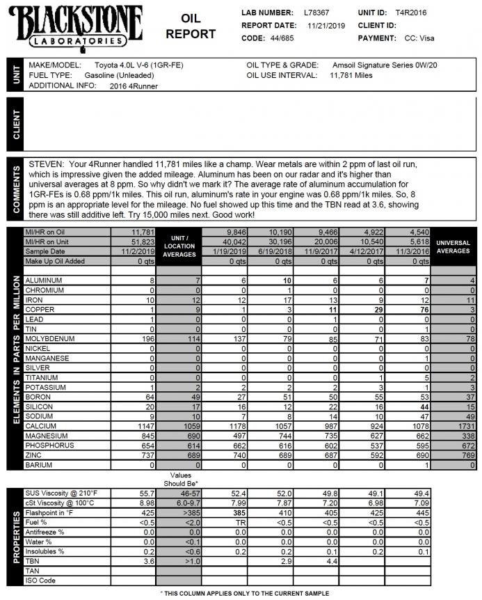

Got my first UOA from Blackstone after using Amsoil SS 0W-20 (11,781 miles on the oil). Here it is for everyone's perusing pleasure.
I’m not sure where the sensor is but the temperature is quite alarming, i’m thinking about getting a thermal gun and measuring the pan temperature and comparing it with the gauge. I might try and surf YouTube tonight to see if I can find out where that engine oil temperature sensor is. Or maybe I’ll try and stop by the dealership tomorrow. This is definitely something I want to get to the bottom of.
definitely let us know what you find. my understanding, based on searching around on this forum, the FJ forums, and Tacoma forums is that the 1GR doesn't have an oil temp sensor (only sensors for coolant and trans temp), and a binary oil pressure sensor for the dummy light in the dash.
as for reported oil temps, seems to be a very hard bit of info to find. people seem mostly interested in running oil pressure, cool temp and trans temp gauges. very little info out there about indicated 1GR oil temps....most likely because these engines are so reliable, most people can't be bothered.
Oil temp is going to be acceptable with a coolant temp of more than 180. Synth is stable to 425 so overheating the oil just isn't an issue except for the case of a catastrophic failure being imminent. I HAVE noticed the 4Runner has a ''lazy'' thermostat that takes a very long time to get up to temp even in 120 degree temps with the A/C on?! Anyone know if they are 195 thermostats?
I would say it has a 180 degree thermostat judging by my gauge, or maybe a 185, I’ve never seen my coolant temps go over 190.
I have not seen a thermostat colder than 192 in an emissions controlled vehicle in 30 years!......and a 180 would certainly cost some mpg! Engine must get over 160 just to go into closed loop on the ECU! Maybe the slow rise to temp is part of the reason We all are disappointed in the MPG? It would be running very rich until it gets up to running temp and that needs to be around 200 for efficiency.
your temps look normal but the engine oil temp does not look correct. should be 250F area .. temp is on your reader 150F ??? not correct.. engine oil gets way hotter than transmission and coolant .
pistons cause the higher oil heat.
my 2016 runner engine temp rises pretty quick in normal air temps 50-80F.. if its 20F out and I have the heater blowing on the max YA it does take a bit longer.
I put a plastic shield in front of the ac condenser in the cold weather below 30F 50% covered.. reason I do it , I want my toes to get nice and warm quickly ..
engine temps 180-185F range very stable because it has a manual fan not electric ..
electric fans do work well when cold temps hit .. heat rises quicker than mechanical fan..
in hot weather the electric fans do cause temps to rise in the 225F range with the ac off when in traffic ..
I have 4 vehicles all with different coolant systems .. toyota system I like .. works very well compared to the GM vehicles.
